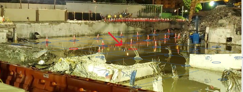

Now we're in the demolition phase, I wonder if anyone saw the point where they dug down to the garage deck? By the time I saw it, they had already removed all the columns, so there was no way to tell if M11 (which is the one 'missing' in the TikTok video, right?) was on its side rather than standing in punch-through like all the others. We may be making a bit much of the column being 'missing' - after all you can't see M12 in that video either and we know that was still standing.
One thing that the demolition videos showed to me is that the lower rebar all looked in pretty good condition, where they'd ripped the columns out. It doesn't look like the water intrusion from the bottom had damaged the column-basement joints.

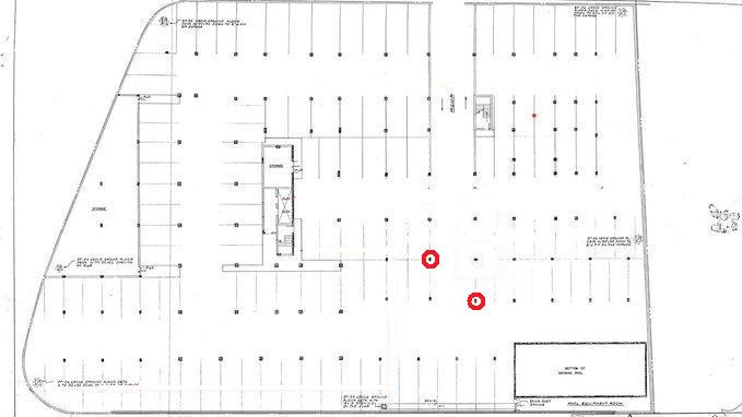

- The timing of those Argentinians coming back versus the TikTok video, the 'loud crash' from the Sirs, and the pool deck collapse. They got back so late that you'd think that crash, which people have suggested is the slab step or M9-M10 beam letting go, would have already happened, but they didn't see anything on entering the garage. Can you get into that garage from the Collins St side? It doesn't look like it. So what was that crash if it wasn't something falling within view of the garage ramp?
The BecauseSurfside channel has broadcast that on YouTube live, but I can't seem to find the video in their archive. I beleive it happened about July 14th...
Please see my post in part 6

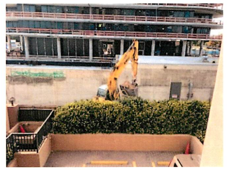

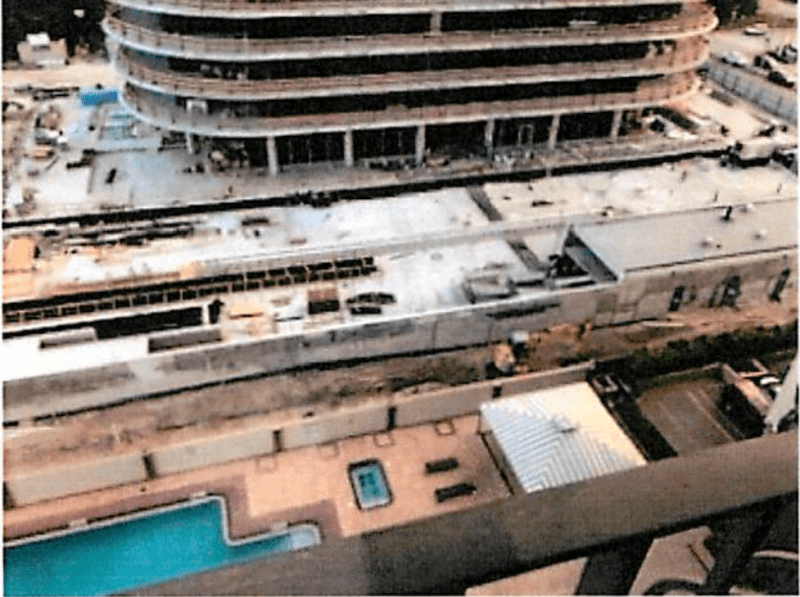

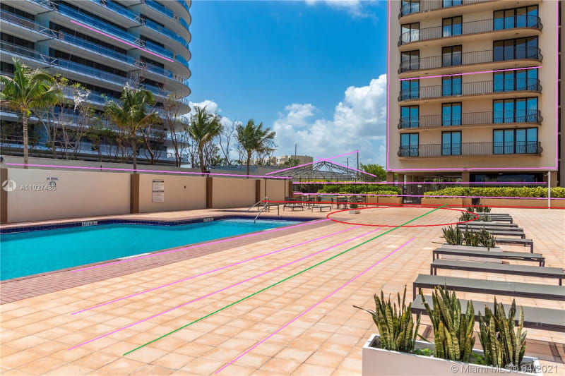

Right Now, and since at least 6:40 PDT (9:40 EST) the search team has been ripping up the pavers midway between the pool and guest parking. They are sawing holes in the pool deck and removing the slab with an excavator.

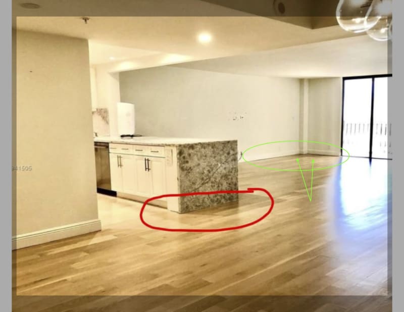

Below is a picture of Unit 1010 posted on part 2 of this thread noting what appears to be deflection in the slab at the end of counter top (red circle). Not sure how long before collapse this picture was taken.
What has troubled me about this picture, and I don't think it has been mentioned, is the green area around Column K. It appears the slab had dropped in relation to it's attachment to the column, but somehow the slab is being supported by load transfer to other elements of the structure. Of course I am ass_u_ming that the baseboard in this area was actually flush with finish floor when the flooring was installed.
Shadows. Other angles of the same room show no deflection.
As I have not seen them posted anywhere after scrolling back through.
Thanks Demented. I was having a hard time explaining that one in my 'Vintage Brain'. I see something interesting in your pictures. It appears the sliding glass door frame is sandwiched on both sides by finish floor heights that are noticeably higher than original finish floor height.
4" spacing between those railing bars for the record. 3-7/8" if the shop that made them was as good as they claim they were back in the day. That's not a 2" spacing beneath the channel. I'm not having any luck finding any work permits for 1010.
That unit definitely has flooring that is substantially higher.

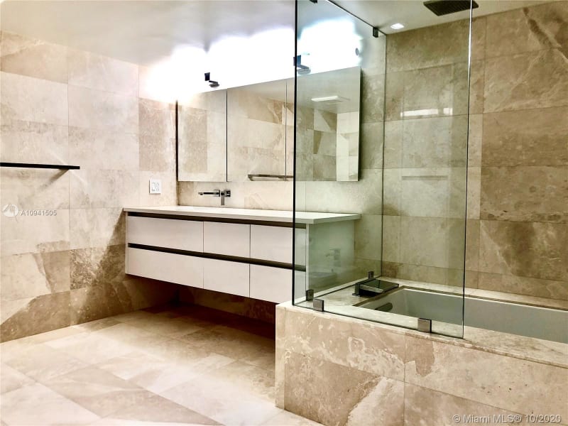

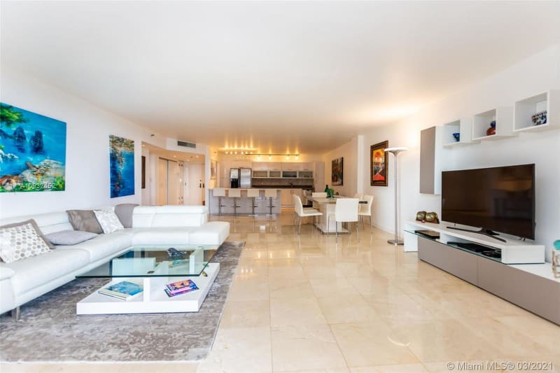

There was never any calculations figured in for all of these units being fitted with marble flooring, bathroom, kitchen counter-tops, or all of the added weight of hurricane windows either?

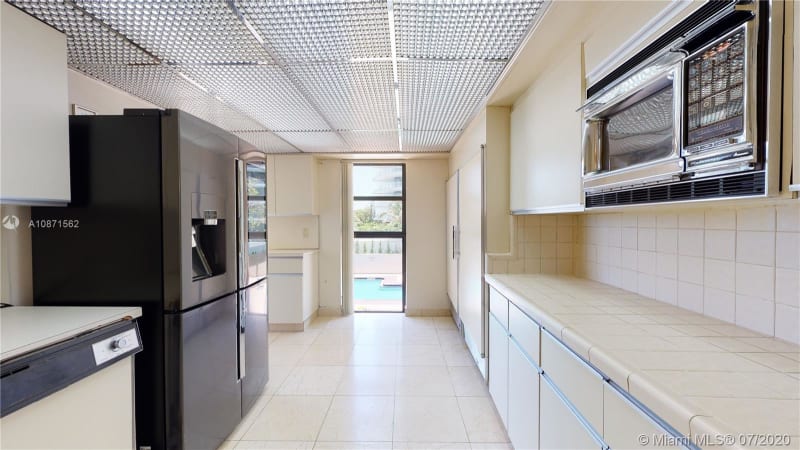

Finally. Original an condo unit.
Unit 212

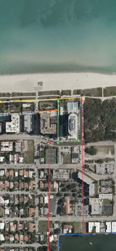

Was there a sea wall in the plans? Was the East facing wall in the parking garage what was intended to be the barricade between the ocean tides and the interior of the building? Water does flow 2-3ft below sea level here.
Permanent Site Bulkhead (orange) along the eastern lot line, 120’ west of the hardpack bulkhead (yellow). Retaining wall along the other boundaries. The bulkhead now visible visible along the south wall (green) was added in 2019 during construction of 87 Park. Blue is Tatum bulkhead, northern red is the assumed location of the old Biscay Island bulkhead, southern reds are the Normandy Beach bulkhead.
The west side of Collins Ave there was the eastern shore of biscayne bay with “The Quarry” located between Collins and the ocean at what is today 87th terrace and 88th St.
A sub-basement level exists below the garage slab.

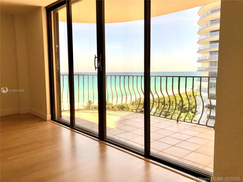

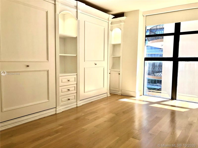

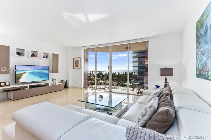

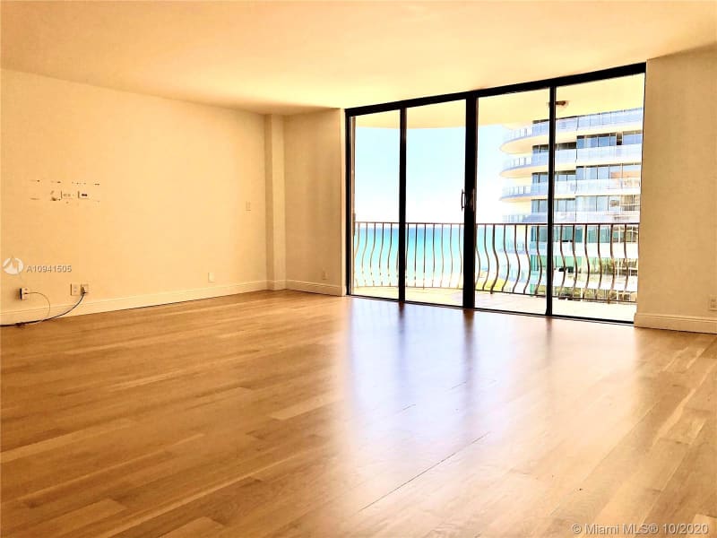

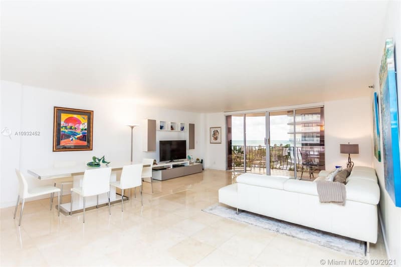

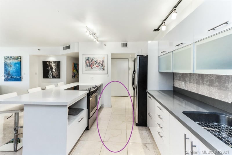

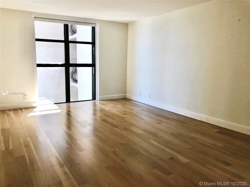

Unit 511, images from March 2021
611 above it for comparison. 611 was the resident who noticed the cracks at the start of the collapse.
This unit appears it does have evidence of failure. That floor aint right. Door gaps are not even horizontally but are vertically. Cracking evident along single rows of tile. Sliding glass door is sunken in.

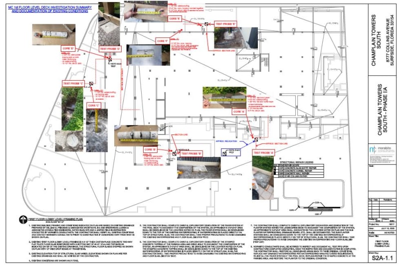

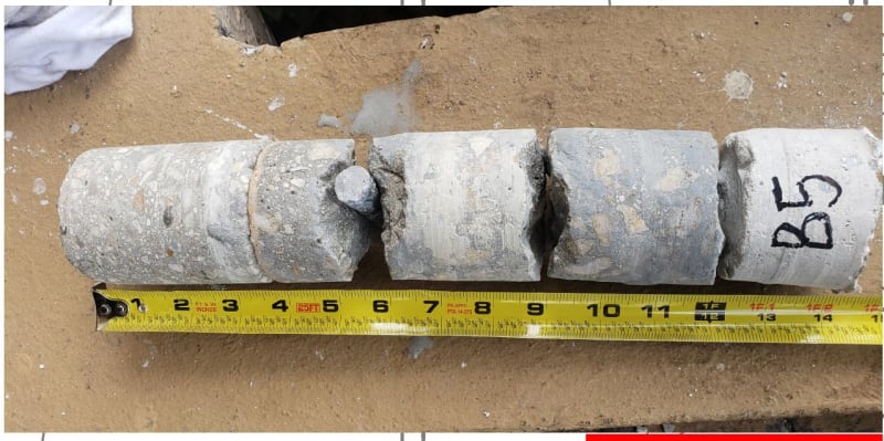

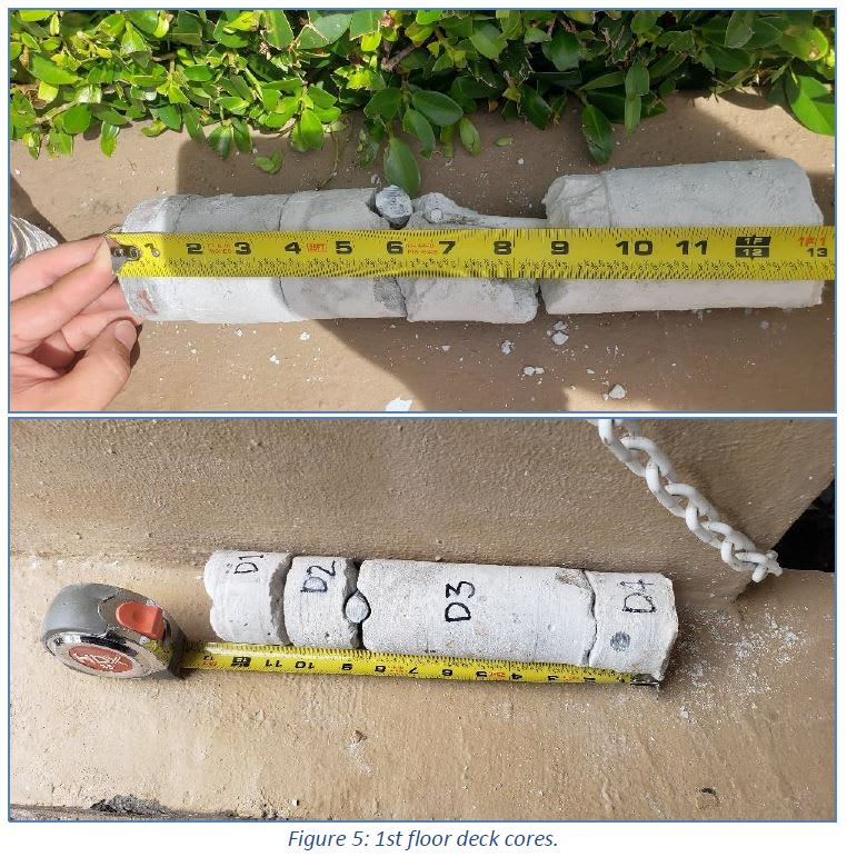

Throughout the TOWN OF SURFSIDE memo (ref Date: July 7, 2021) it REPEATABLY STATES:
"after GPR to AVOID reinforcing steel" when taking concrete core samples...
The M.C. Oct. 2020 report shows core samples that were taken of the C.T.S. pool deck concrete slab cutting completely through multiple reinforcing bars...

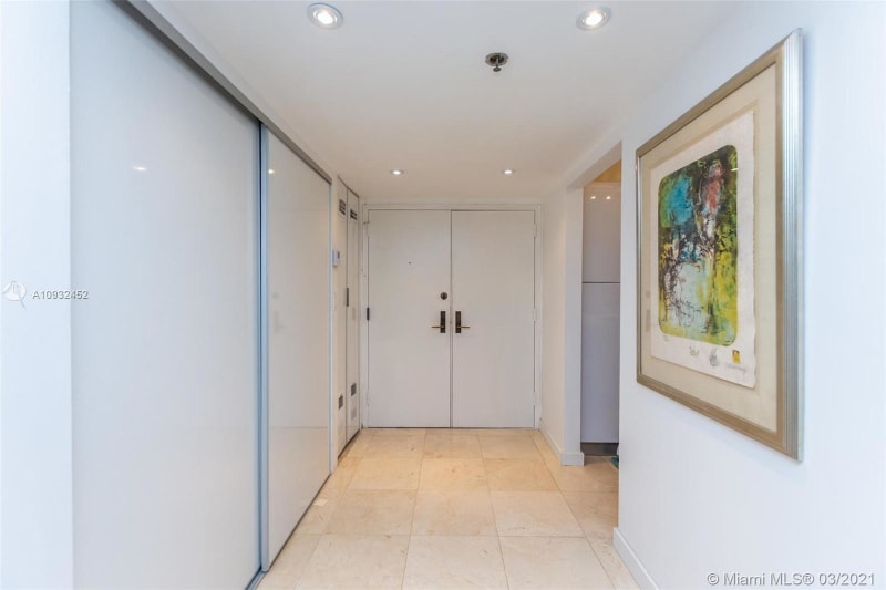

The front doorframe to the building's corridor certainly looks twisted. It appears that the M column line has dropped a fair bit relative to the L line. Mentally extrapolating the gap at the top of the M-side door to the width of the L–M span, it could have dropped by more than an inch, assuming a uniform deformation across the span. That feels like a rather bad thing and sign of significant distress.
Maybe we are looking at some sort of compressive failure in overload scenario? If it hit the M line worse, maybe that could have failed the beam attached to M9.1 ahead of total failure, to collapse the pool deck ahead of the tower?
