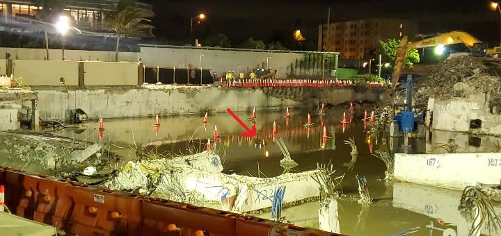

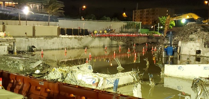

Interesting. They put a cone where each column should be located and it seems that at least one column is missing

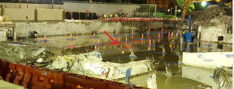

inspired by your cone-counting I tried lining them up. I also get a missing cone close to your red arrow (red circles), also one further to the left left (east) and further back, depending on how you line things up. I'm sure the CAD gurus will do a more formal job of this, but it is certainly difficult to find all the columns that should be there.
Ummm... the more likely explanation is that the site safety
officer put a cone where there was a tripping hazard hidden below the water's surface.
There is no need to keep the column locations marked while the site is being demoed.
The remains of columns and all the other rubble have been moved offsite for further study.
The land will be cleared and made ready for a memorial or sold to a new developer.
The cones aren't always over columns. On-site folks are moving them around sometimes.

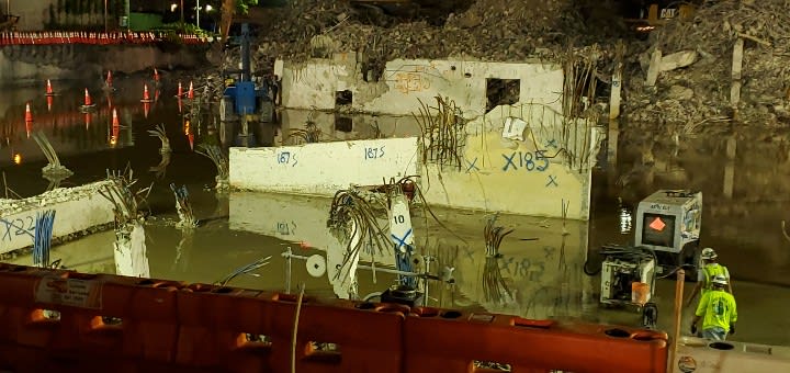

Yesterday, this cone was over a column but these people came by, chatted for a few minutes, then picked this cone up and moved it a few feet away for some reason. It remained there for the rest of the day.

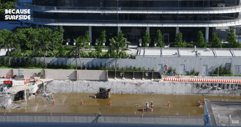

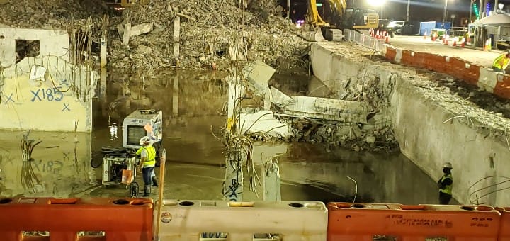

The mini dozer was fighting a losing battle, the water level continued to rise, apparently coinciding with high tide. It is going to be interesting to see what the foundations look like under that slab.

Or perhaps the water table is so high here. Reports say that standing water in the garage had to be pumped out regularly and often was a losing battle. Building Integrity YT channel actually talked about this in his recent video. He posits that the fluctuating water table level contributed to subsidence and that the water could have been leaching into the columns from below. He shows some photos from the garage walk thru that show possible water saturation at the base of the columns.
How did they pour the original slab, if there was (salt?) water to wade in?
spsalso
spsalso
Steel cribbing to be a make-shift damn that slows the water ingress is the standard here. Leave in ground or remove, typically remove if it's not at a remaining sea wall.
Was there a sea wall in the plans? Was the East facing wall in the parking garage what was intended to be the barricade between the ocean tides and the interior of the building? Water does flow 2-3ft below sea level here.
It's like the 'bathtub' underneath the World Trade Center - a lot of attention went to shoring it up during the recovery / cleanup efforts after 9/11. Looks like in this case, the 'bathtub' under the condo here had some leaks.
spsalso - another method they use to control water in big excavations like this during construction is called well pointing. Basically a series of pretty shallow wells that surround the perimeter of the excavation. The wells draw the groundwater, water table down in an attempt to keep the water from reaching the excavation.
As for these pictures, it doesn't look like they're trying too hard to keep it dry cause I only see a couple pumps. At some point they make a more serious effort at pumping if they want to get a better look at the slab and foundations.
