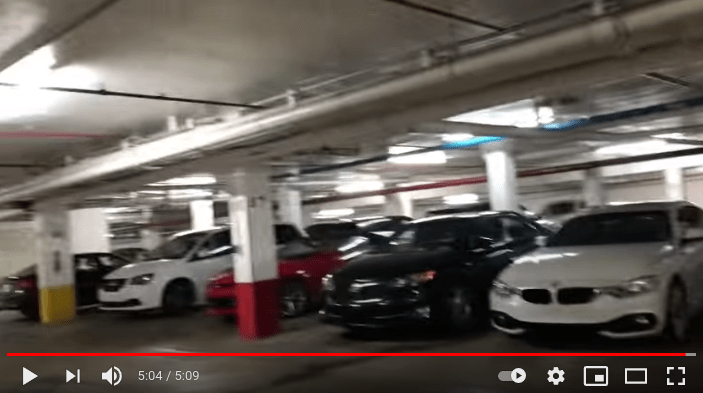

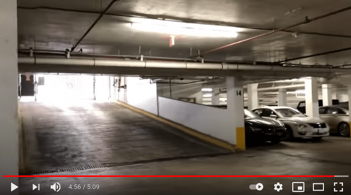

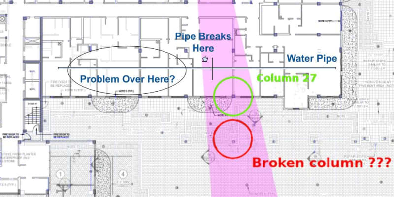

One thing that seems a bit strange in that video is the water pipe near the garage entrance:
Here's another shot of it when she pans to the left:
This is the same pipe that's broken in the tiktok video:
I always figured that it broke because it turned towards the pool at that spot, but it's clear that it doesn't. Instead this seems to point towards a failure near this circle before the video started:
I think this might indicate that the tiktok video and the ring video were taken at the exact same time. I always assumed the tiktok video was a few minutes earlier, but this does line up well with how the kitchen dividing wall is leaning in the ring video. Perhaps there were already multiple columns under the building that were collapsed when she started taking the video.

So let's look at some numbers if we assume the Tik Tok column is collapsed.
Column at L/10 - the yellow painted column adjacent to the presumed failed column in the Tik Tok video - is a 16"x16" column with 8-#11 at the basement level. Rough numbers assuming 50% live load, it was carrying 640k. The 9 1/2" plaza slab frames into it with hooked #5 at 12". Assuming yielding of the slab (moment = 11.6 ft-k / ft) for the full tributary width of that column puts 240 ft-k of added moment to that column. Much of that moment would redistribute into the Lobby slab (only a 7" elevation difference). Column interaction diagram gives us a Phi Pn = 640 k with a phi Mn = 240 ft-k. While redistributing moment into the lobby slab will remove some moment, it will also increase axial load to the column from the lobby floor (maybe 15k). Another nearby point on the interaction diagram is 710 k, 220 ft-k. So this is close, but still under the limits of that column.
The collapsed column would get the building column close to failure but not necessarily exceed the column capacity immediately. This allows for the progression of failures to occur as provided by witnesses. I'm still resistant because a vehicle impact on a 12x16 reinforced column (beam connected)supporting 30,000 lbs of weight would not impart enough energy to really even be noticed by that column. To me, the failure is from something else.

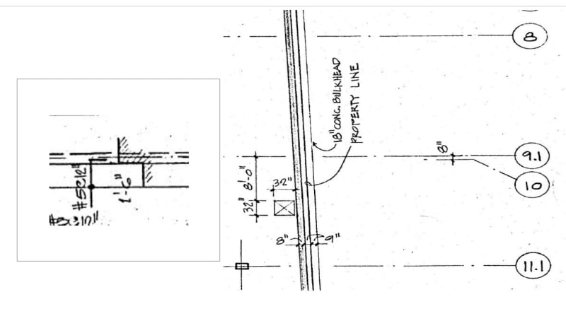

Can anyone comment on drawing S.5 of 14 showing:
[Pool side of the BLD that collapsed]
UPDATE-
1.) Basement Column line 9.1 (offset 8") from the grade level of building Column line 10
. (answer for offset of 8" is because it is not the center line of the column but the outside edge of the column)
2.) Change in slab Elevation along/near column 9.1
. (this may or may not have been a contributing cause of the collapse)
3.) No Beam (BM-A) under at column I / 10
. (answer is because change in slab elevation is within the column)
Sections taken from S.5 (Pg. 31 of 336) .
GPR, 1) There is not really an offset. 9.1 is column CL, 10 is outside line of building. 2) Pool deck is 18" below lobby level. 3)BM A is required at column lines K-M because there is a slab step mid slap between 10 and 11. Column line I steps down the full 18" on line 10, so beams would not be required.

My old eyes see what seems to be a slight pitch downward in that large, white pipe. Even if there is no slope, it looks more like a PVC drainpipe of some sort rather than a pressurized water line.
The south-pointing spray direction of the water in the TikTok video says to me it is one of those red fire sprinkler water lines that broke, perhaps the one on the right side above the ramp in your first attached image. If so, I am still perplexed why the fire alarm didn't sound, which could have saved many more lives. Instead we had a few residents (and even the security guard) wondering what all the loud noises were and everyone else remained unaware anything was happening.
On a slighltly related note, that garage video once again confirms what was reported in 2018 - the exposed sections of the concrete deck lacked sufficient waterproofing and were moist enough to cause the paint to peel off.

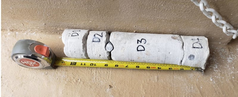

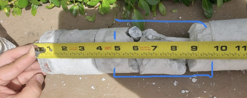

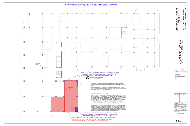

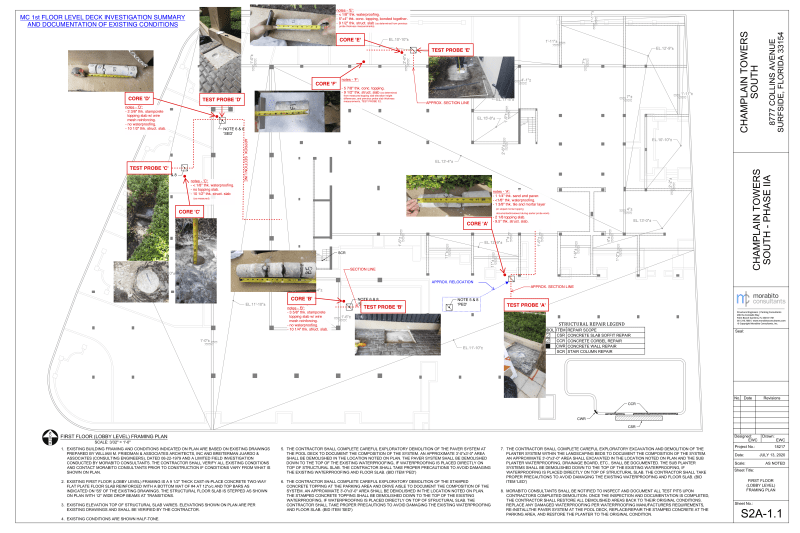

I'm not sure if it was mentioned yet but I wanted to add this because I just found it. It's their minutes report from their October 2020 meeting. It looks like they did exploratory demolitions and there's some photos in there.
This appears to be where the "curious results" is from.
This initial work yielded
some curious results as it pertained to the structural slab’s depth, and MC requested that additional core work be
performed by CPR to confirm/clear-up said results. CPR performed 6 separate cores at the direction of MC. The
results of exploratory demolition and the additional core work are summarized in the attached “CTS Test Probe
Notes” file.
Direct link:
Source:
Regarding the broken water line in the intermediate collapse video into the garage… wouldn’t there be much more flow from this line if it were a broken main or fire suppression line?
Did they really have to cut right through the Rebar?
and then how did they, after coring through the Rebar restored each exploratory (and core) location back to its original
condition?
Pg 39 of 83 "At completion of the investigative work CPR restored each exploratory (and core) location back to its original
condition"

Those core samples should have been an immediate cause for shoring up the slab. There’s way too much structural steel for it not to be obvious something was off.
