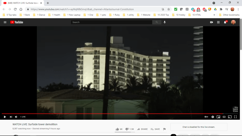

WATCH LIVE: Surfside tower demolition
SF Charlie
Eng-Tips.com Forum Policies
Notice in the demolition video, looking south - the parapet over the x04 living room came free completely and yet remained intact. As if it wasn’t attached at all.

The initial collapse was far more elegant...
Definitely an interesting development...
Keith_1 said:
WOW, to do that in 24hrs, without any prep, I'am simply speechless. I didn't think that they were only doing were doing any placement of charges above the 1st elevated floor, but I was clearly wrong. I have no Idea how this was mobilized, or performed in such a quick manner, but WOW.
That's the Loizeaux family for you. From what I read, it was basically small sequenced charges in the columns at basement and ground level, nothing in the tower. Gravity and relatively weak slab-column connections did the rest.

Yes, that is my point, the upper parapet over x10 seems to have fallen in a different direction and more slowly than the rest of the building.
