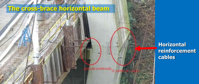

Two images from that link that seem to support the more probable cause being failure of the tie-beam:
1] Exceptionally small quantity of post-tensioning within the tie-beam:

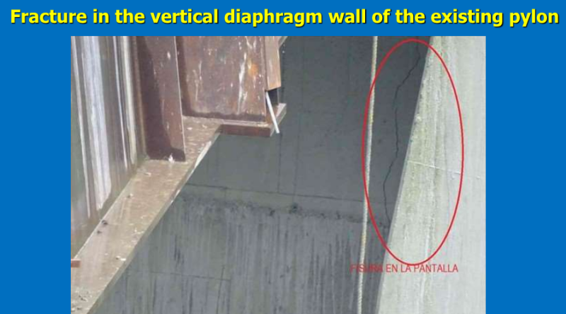

2] Significantly-sized vertical crack, that appears to be inboard of the tower column, within the web-diaphragm:
Also, it has been previously reported that similar cracks (and pending failure/collapse?) have been observed in the other tower - so this further suggests the tie-beam is the probable cause. However, granted, that all aspects need to be investigated, including foundations.
I assume the crack shown IS in the existing/other tower.
One would hope so - otherwise it was negligent to NOT report and act upon such a crack BEFORE the collapse.
"One would hope so - otherwise it was negligent to NOT report and act upon such a crack BEFORE the collapse.
It would be oddly coincidental for the crack to be the existing tower and only to have appeared AFTER the collapse. I'm tempted to think that the cracks existed and were explained away by management intent on completing the bridge before the overrun got much worse.

The cable reinforcement looks sketchy to me; there appears to be as many as there are in my post-tensioned slab, which is not under anywhere near the same tension stresses.

I would hazard to guess that something must have seriously gone wrong with the design for the cross tie to have that low level of reinforcement. Guess time will tell why it made it through into the construction.
 http://files.engineering.com/getfile.aspx?folder=fa97ccf8-b464-4800-b9ad-e10df99024b6&file=FIRST_REPORT_OF_THE_SPECIALIZED_TECHNIC...THE_DEPLOYMENT_OF_THE_CHIRAJARÁ_BRIDGE_-_rough_english_translation.pdf
Page 14;
The existing prestress in the braces is....................316.92 ton which is less than existing tension load of 375.48 ton.....
