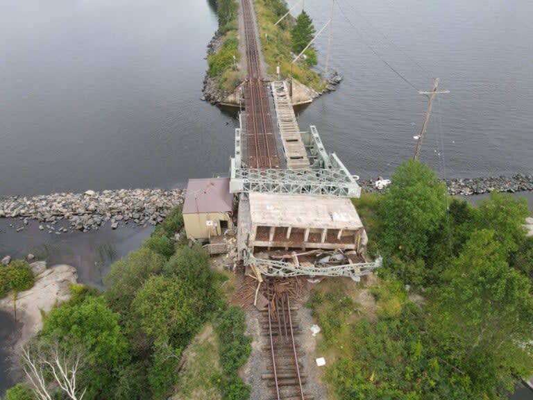

I have hard time explaining damage to building and ground below the stub end, if stub was fully attached when counterweight fell, and the sheared bolts happened after counter weight hit ground. My take is leg stub disconnected from bearing hub assembly while in air and slid off leaf into building doing ground and lower damage, prior to ending up horizontal and damaging building wall from ground up to resting point.
Notice also that the disconnected stub moved laterally into building, which also caused twisting of of the counterweight pivot connection on the other side.
Edit: Waross, I don't discount that there could have been issues at top of counterweight, as that is a hard area to inspect, and one that could go unnoticed for long periods of time. But I clearly think stub separation caused the twisting and over loading of the other counterweight upright.

waross, I do follow your logic, and I see that an upper issue could have been the initial domino, and any binding or loss of connection at one side of upper CW attachment could cause the shearing of bolts from stub to bearing connector assy. It appears in pictures that the bottom edge of CW on the side with bent lower support leg is touching ground, but the other bottom side is not. It also appears concrete CW contacted train rails, as you can see impact zone, then slid away from bridge pivot points, on building side, after it was on the ground.
But, I keep coming back to the image above and can't explain building damage below CW lower support stub. I do believe counterweight is skewed laterally into building and it has fallen further away from from counterweight lower pivot point. I can't tell for sure, but it appears the lower CW support leg may be bent inward towards the other support leg? Also the side away from building has collapsed lower to ground than building side.
The stub does not appear to have contacted pit wall on building side, like the other side, which indicates perhaps a lot of torsional and lateral movement in the gantry and CW assembly before splash down or on the way down.
It appears CW had to maintain some sort of connection at the top to the gantry to be able to pull the gantry down. Perhaps one side failed and the other side did not? I do feel the damage is skewed towards building and away from pivot point on building side.
I give up, I have exhausted all the brain cells I have, and I still cannot see any conclusive answers from the available data set....

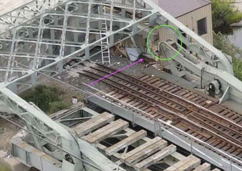

Arrow points to upper gantry bearing which detached and fell down. The proximal green (greyish) parts are from the upper gantry arm.

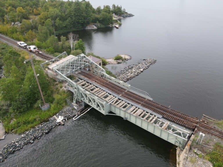

Looking at 409s picture above this double track bridge could never have operated that way looking at the single track causeway. So 115 years of slightly off balanced load had an effect?
The balance forces are very tightly matched to achieve low opening and closing on the rack and pinion so did this slight difference in lift force one side to the other just finally catch up with it?
Thanks for those final missing pieces that I could not see in images! Binding/failure and detachment of upper gantry control arm and asymetric loading fills in the missing pieces. Also notice all the scrap rails that spilled out of counterweight on building side of CW that was added to counter bslance heavier track side.
