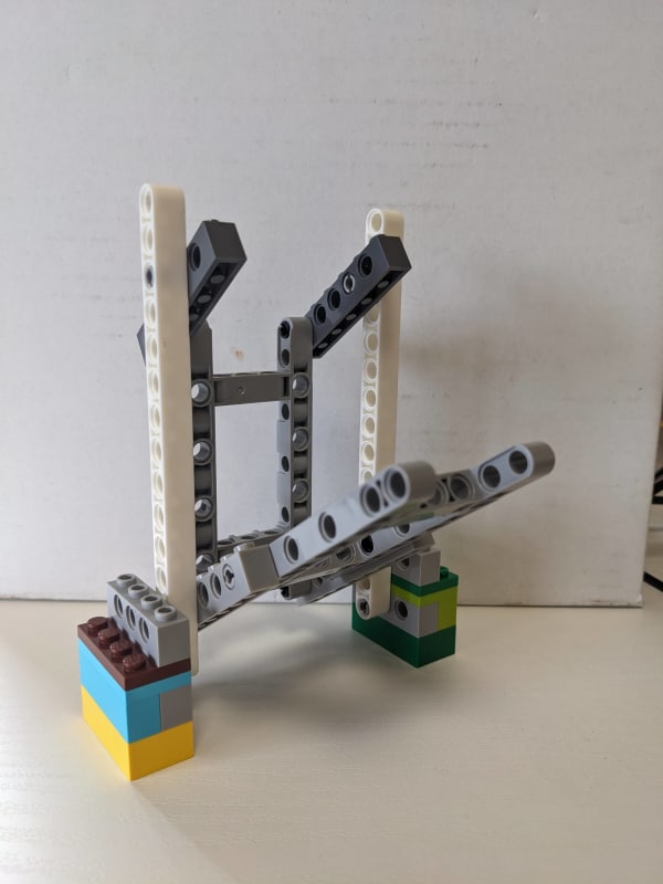

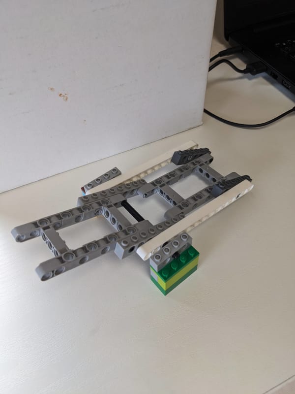

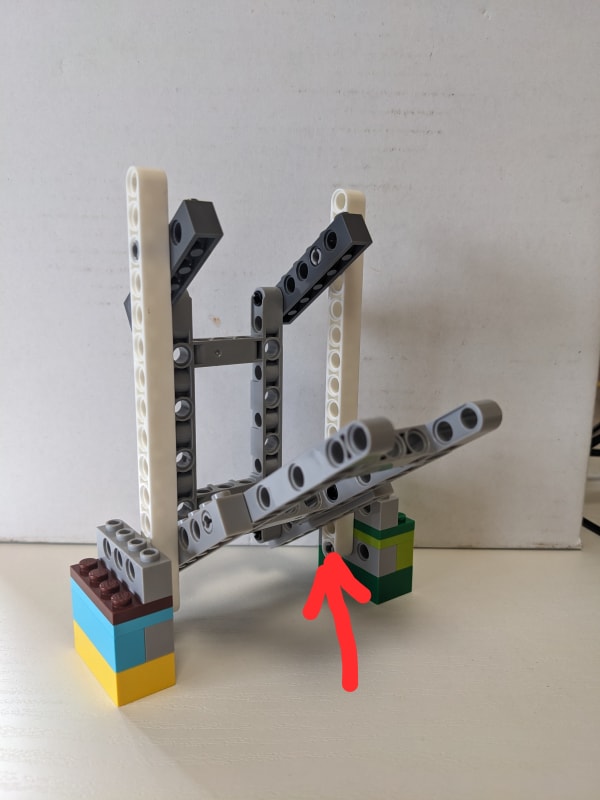

Here's my forensic Lego model and analysis.
Failure of the pin on each side here
results in exactly the failed condition shown in the photos.
I am in agreement with 3DDave and OOps409.
This is a parallelogram mechanism.
The vertical structure (gantry?) does not move, It is the one rigid side of the parallelogram.
It is possible to design it with no lateral loading other than wind loading.
While it may not be designed for completely zero lateral loading the loading will be very low.
Given a combination of serious corrosion and a powerful wind storm, it may have deflected.
Once it deflects, the lateral loading will increase and it may proceed to destruction.

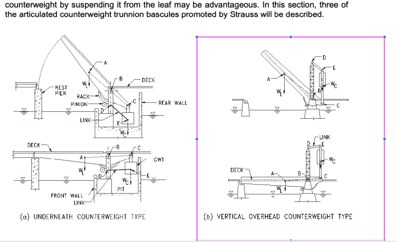

Here is the complete paragraph to go with the drawing above, from a Wisconsin Structural Inspection Manual for Chapter 3.2 Bascule Bridges. Link to pdf uploaded
"3.2.4 Articulated Counterweight Bascules – Strauss Type
Medium and long span simple trunnion deck bascules with the roadway profile close to the high-water level generally require bascule piers with counterweight pits. The walls of the bascule piers keep the water from entering the pits and so provide dry spaces for the counterweights as the bascule leaves rotate open. This is also the case for rolling lift deck bascules, but to a lesser extent. Counterweight pits can be avoided if the counterweights are located remote from the bascule girder, usually overhead.
Trunnion bascules may be balanced by counterweights that are not fixed to the bascule truss or girders. This concept is old, but U.S. Patents for bascules with remote counterweights were granted to Joseph B. Strauss around the year 1900 and bridges with his specific counterweight arrangements are often called Strauss bascules. Three common versions are shown in Figure 3.2.4-1. The distinguishing feature of all Strauss bascules is the parallelogram connecting the counterweight to the movable leaf. In all Strauss bascules the motion of the leaf is by rotation about a fixed horizontal axis.
In some situations, it is not the depth of the required pit but the front-to-back dimension of the pit that needs to be minimized, as in Figure 3.2.4-1 (a). In such cases articulating the counterweight by suspending it from the leaf may be advantageous. In this section, three of the articulated counterweight trunnion bascules promoted by Strauss will be described."

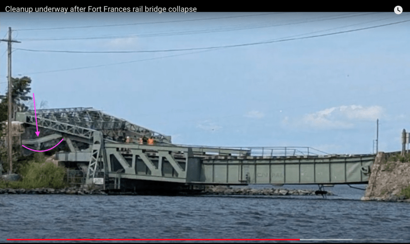

I can't see the details of the bottom connection of the towers, but the location of the failure seems to be at the bridge pivot point.
A theory:
The bridge was lowered to allow a train to pass.
That would have put the counterweight in the upper position.
The bearings on the gantry end of the links seized or jammed.
As the bridge was raised, the counterweight lowered and the jammed bearings imparted a torque to the gantry structure that caused it to topple towards and on top of the counterweight.
Root cause:
Corrosion damage to both the gantry and to the bearings at the top of the gantry.

This picture shows the failure to be above the pivot point. (maybe)

This is why I love this site - far better explanation than any of the news sites. Great find for the diagrams etc. Amazing really that this design is still functioning 115 years later.

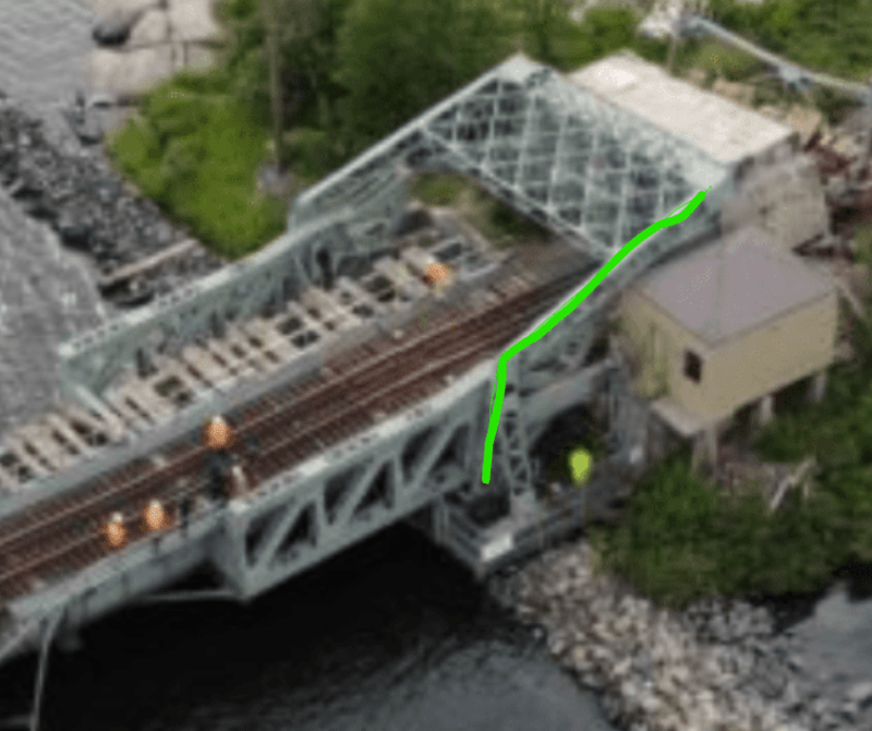

It might not help that it looks like it was designed for a double track lift, but they lifted the rails and some of the sleepers on one side. Might be small, but for something as delicately balanced as this might make a difference long term?

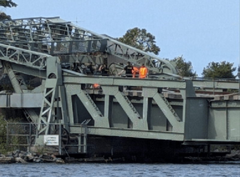

I lean towards the thin vertical leg supporting counterweight to the lever arm in the forefront of waross's picture failed. Thus causing the loss of support and torsion loads on gantry. Notice forefront side is collapsed lower than the other side. Thus also loss of counterweight to hold bridge up. Or pin connection failure at lever arm connection.

Slight Correction. Foreground pin connection from counter weight to lever arm (leaf) is still attached in picture. While the background vertical appears to be broken away and separated from the lever (leaf) arm.
Second pictures shows bent vertical support for counterweight, due to loss of connection on other side.

The picture shows no contradiction to my theory.
The gantry and the top links serve to keep the counterweight CoG vertical over the lower pivot.
There is little side force on the gantry save for wind loading and possible slight construction errors.
Anyone who has ever held a heavy appliance balanced upon one bottom edge knows how little force it takes to keep the appliance balanced and how quickly the force needed multiplies as the object tilts away from the balance point.
When a link arm bearing seizes up on top of the gantry, the weight of the descending counterweight put an unanticipated force on the gantry.
Once the gantry deflected, the CoG of the counterweight shifted away from the vertical with respect to the lower pivot support.
That shift increased the unanticipated horizontal forces on the gantry and complete collapse was almost immediate.
The bottom of the counterweight support rests and is pivoted to the back end of the bridge deck extension.
As the gantry collapsed and the counterweight fell over, the counterweight supports would simply pivot without experiencing any great destructive force.
A suggestion MintJulep
A modification to your forensic model:
Weaken the white vertical members at or above the lower pivots to simulate corrosion deterioration.
I suggest cutting most of the way through the members with a hacksaw or something similar.
The model should still be able to function to simulate raising and lowering.
Now fix or pin the upper pivots on the white vertical members to simulate seized bearings and prevent rotation.
Do this with the deck in the down position.
Now, with the upper pivots unable to pivot as intended and the lower part of the white verticals severely weakened attempt to raise the deck.
I anticipate that we will see a failure similar to the actual event.
It may be interesting to actually load the arms simulating the counterweight with some weights.
The CoG of the added weight must be directly vertically above the lower pivots.
I anticipate that the model will function well with considerable weight even with the vertical supports compromised but that the model will collapse when the upper pivots are restrained.
Thank you for your consideration of this suggestion.
