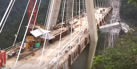

A major bridge, 440 metres span, collapsed during construction. Seems to be a cable-stayed bridge with concrete towers and deck. Seems like one tower and span collapsed during construction, killing at least 10 workers.
A bit more detail and photos showing the scale of the bridge
It's not easy to see from that video which is though the best seen so far, but it looks to me like the first two cables just to the left as we look at it from the main tower start moving and flexing just before the rest. Would therefore look like the far strut of the V collapsed before anything else di, but it is not easy to see cause as opposed to consequence.
Very sudden catastrophic collapse though. you would have thought something would have started to crack or creak or moan at some point before the initial collapse.
I am with LittleInch on this one, my take on the video (@ 0.25 speed on Youtube) is the same as his.
On the 'sudden failure' aspect, would that suggest the furthest fork failed in shear right where the /\ section joins the V of the fork?
That said, it looks as though there is a good amount of dust kicked off the inside of the furthest fork - which I suppose suggest the concrete has essentially 'exploded' under the compression load running around the inside of the fork at bridge deck level. Or perhaps it is the re-bar being ripped out of the concrete?
I would expect the deck is being used to hold the legs of the tower together. To me, it appears the deck to tower joint failed on the far side first.

Well, the towers are absolutely under increasing compression loads from the top down to the V-split. Then, these compression loads are split in two, and become tension loads pulling the two V's further apart. Like two wishbones being pushed down from both ends, the middle of the wishbone is being pulled apart.
So, the weakest concrete and rebar at the top or bottom of the weakest joint of the four will fail first.

If you look at the tower that's still standing, there's a concrete diaphragm wall between the two inclined piers up to the deck level - e.g. see:
This photo also suggests a beam or corbel on top of the diaphragm wall, which looks like it supports the roadway deck. Presumably, one of the functions of the diaphragm wall and / or the top beam is to resist the spreading force of the two piers?
It's hard to see this wall in the collapse video but if you look carefully , you can just about convince yourself that "something" explodes between the legs, and at 0'14", you can see a dark line down the centre of the far pier - is this where the diaphragm wall just pulled away?
Is this a case of inadequate horizontal tension capacity (either by poor design / detailing, or construction defect) of the diaphragm wall between the two inclined piers?

It appears to me the initial failure was a tension failure in the diaphragm under the deck that was holding the two V-struts together. The deck is entirely supported by cables so I doubt that thee was any deck loading onto this diaphragm or the beam at the top of the diaphragm.

Unfortunately I don't think the video actually captures the initial fault. Right at the start of the section with the collapse if you pause and look at the cables closet to the tower they are already not straight and not under tension so it look to me like the tower had already started moving at that point.
