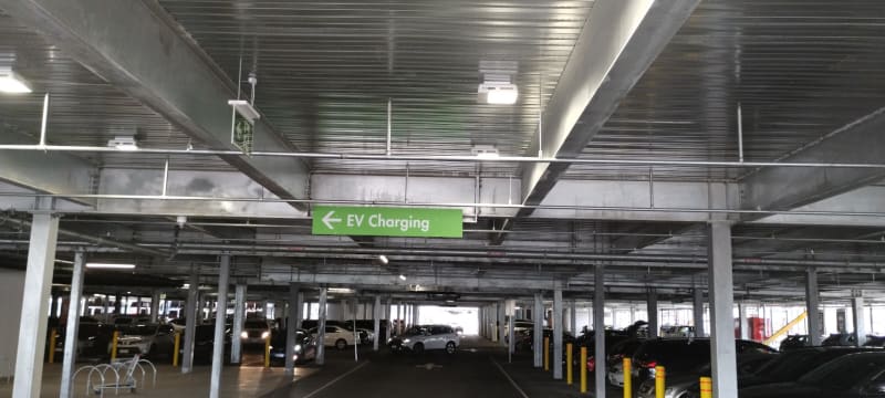

I have done several free standing steel parking structures in Australia. None had fireproofing of any kind, as it wasn't required. Possibly, this will be changed with more modern vehicles and experience. These steel carparks were exceptions, as most carparks in Australia are cast in place, posttensioned.

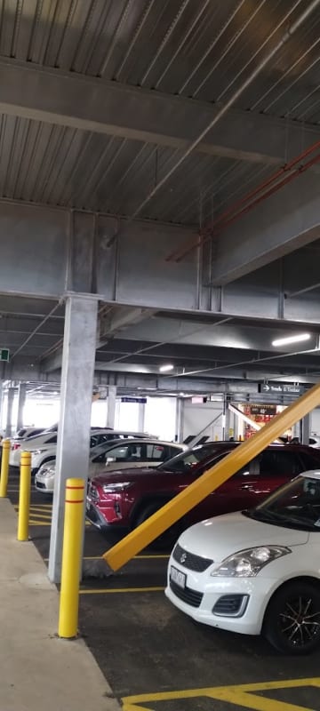

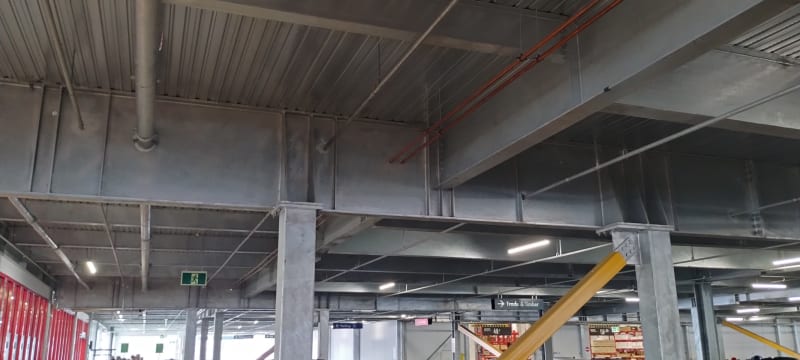

I just thought I'd follow up on this. This is a photo from an newly built hardware store (Bunnings) in Melbourne, Australia. A massive complex, 2 stories of parking below the retail hardware store. Lots of big steel. Lots of cars. And a some EV charging thrown in. I will note that as I entered there were two quite large water storage tanks onsite presumably for the sole purpose of addressing fire.
Fully sprinklered, by the look of it. Probably because it is not a freestanding carpark, but under a retail store above. I think most Bunnings stores have those large tanks, which collect the roof drainage. Fire fighting is probably the main usage of the tank water, but maybe not the only use.

Interesting structure. HSS columns to US of beams with stiffeners to carry what I assume are column loads through the beams. The beams being continuous to minimise moment. The secondary beams at nearly 1/3 points to minimise the moment again and slightly offset from the columns as not to interfere with the column load transfer. If I read that correctly.
It was interesting. If I'm there again I might have another look. To be honest I'm quite used to seeing poor steel design and detailing in Australian structures. Nothing seems badly amiss here, though I didn't look closely.
Yes. This was the ground floor with two levels above. I would presume that HSS was used to minimise the surface area to mass ratio. In other locations of very high load where transfer beams were present heavy I-sections were used.
I'd say you have mostly read that correctly.
I took the images below of one of the deeper transfer beams, maybe 1-1.2m deep. Only after looking at the photos did I realise that the beam seems to be aligned eccentrically to the column. I believe these photos are from the second floor.
