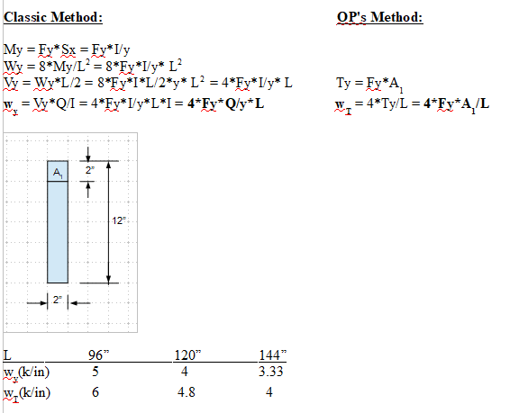

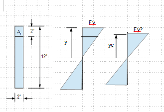

Hi Folks,
Anyone could please explain the principle shown on above screenshot.
I'd like to understand the relationship between the maximum longitudinal shear and maximum plate tensile resistance when assumed elastic distribution stress.
Thanks for your help.
Best Regards,
JPMF

It is the same y in My/I which is the fibre stress at the middle of the plate in the elastic range. My/I is the average stress in the plate in the elastic range but not beyond.
This is what I can't agree. Stress at any point of the cross section is calculated by σ = My/I, for maximum bending stress to occur, the y is measured to the extreme fiber, and the stress varies linearly from the maximum at the extreme fiber to zero at the neutral axis. Think about this: Mmax = Fy*Sx = Fy*I/y, therefore, y must be a maximum. Below is my simple calculation FYI.
Note wy = 4*Fy*Q/y*L = 4*Fy*A1*yc/y*L = wT*(yc/y). yc is measured to the center of element A1, y is to the extreme fiber.
Alternatively, you may want to try using plastic sectional property, that might match your concept (Fy on entire cross section).

Moment is taking over the entire cross section. The composite neutral axis is right on the center, so y = 6" T & B, Sx is the same T and B. Without consider buckling, the maximum elastic moment capacity is Fy*Sx. If you back track your V , w, and get the corresponding M, then calculate the stress by σ = 6M/bd2 = M/Sx, you will see my point.
Does the stress diagram at the rightmost match your thinking?
Let's check moment capacity for these two cases.
1. Classic Method
Force couple, F = Fy*6*2/2 = 6Fy
Lever arm, a = 8"
My = F*a = 48Fy
2. OP's Method (your thinking)
Find stress at extreme fiber, let Fy/yc = Fy'/y ----> Fy' = 1.2 Fy
Force couple, F' = Fy'*6*2/2 = 7.2Fy
Lever arm = 8
M' = 7.2Fy*8 = 57.6Fy
M'/M = 57.6/48 = 1.2 = y/yc
No!!! The bar is stressed to Fy throughout, half in tension, half in compression.

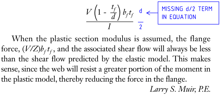

We are on two different orbitals - plastic vs elastic. Forget about it, there is no comparison then. But kind of surprise that shear flow by plastic analysis is only 20% greater than result from elastic analysis.
It is actually LESS for plastic shear flow, compared to [EDIT than] elastic shear flow.
From AISC MSC 'Steel Interchange' of July 2014: Link
With the following formula correction:
Retired13 & BAretired glad to read your comments and the knowledge sharing is a key for growth.

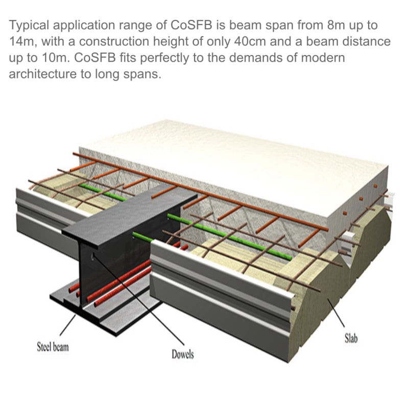

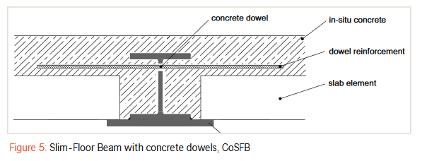

It depends on the function of the plate, cover plate can be used for deflection. Weld is designed per shear flow, which is maximum at the beam end. You can use partial length cover plate if the moment is the sole concern.
Typical application shown on screenshot below.
I hate acronyms. I didn't know what CoSFB meant, so looked it up. It means Composite Slim Floor Beam. That is not familiar to me and I would have to think about it for a while.
Looks like there isn't any fire cover in the picture below. I think you may be correct, retired13. This could be strictly for deflection control, which means that the structure is not relying on the beam and cover plate to sustain the loads. I will have to do some more reading on the system...very interesting.
BA
For 15" thick solid slab, ACI recommends a clear span of 15*33/12 = 41.25'. The above solution seems too complicate and expansive.
Yes that’s right BA. Those compound sections known as “Composite Slimfoor Beams” are a cost-effective shallow floor construction solution ideal to minimise floor depth.
I’m based in Europe and those members are very common in car parks multi-storey, hospitals.
