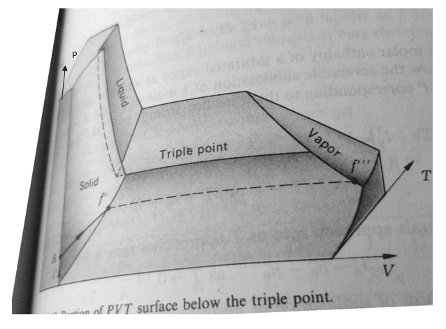

IRstuff said:
If the melting and boiling points are not coincident, then you need to heat the liquid up to the boiling point,
To get the concept right we are heating a solid here, not liquid. Also sublimation happens at constant temperature, similar to boiling and fusion, for a pure substance.
IRstuff said:
Joule heat can be eliminated only if you are dealing with a material at its triple point.
Sublimation can happen at temperature lower than triple point. Refer PVT surface showing triple point.
Horizontal dashed line is the line of sublimation.
