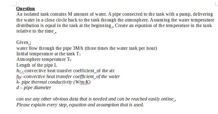

i am designing an hydroponic system , and there is one calculation that really gives me a hard time , i will be very happy if someone can help me with this. I simplified the equation that i need to develop down below. thank you very much for any help.
Question
An isolated tank contains M amount of water. A pipe connected to the tank with a pump, delivering the water in a close circle back to the tank through the atmosphere. Assuming the water temperature distribution is equal in the tank at the beginning . Create an equation of the temperature in the tank relative to the time .
Given :
water flow through the pipe 3M/h (three times the water tank per hour)
Initial temperature at the tank T1
Atmosphere temperature T0
Length of the pipe L
h0 - convective heat transfer coefficient of the air
hW -convective heat transfer coefficient of the water
k- pipe thermal conductivity (W/m·K)
d – pipe diameter
*Can use any other obvious data that is needed and can be reached easily online .
Please explain every step, equation and assumption that is used.

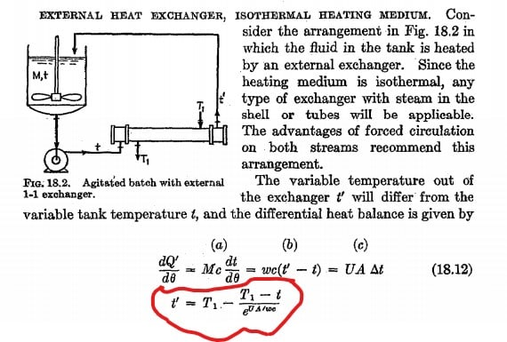

@pierreick has uploaded a file with a great scheme that I think very suitable for this case. I just need to go over it again and understand all the variables there .

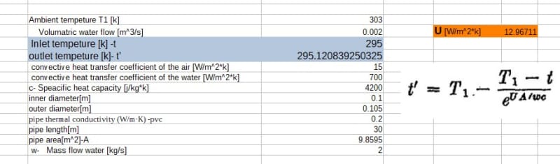

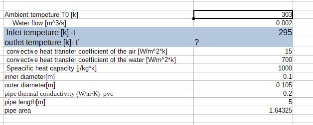

Ok , so now i input some data into the formulas to see if it makes sense.
first i used that formula that was uploaded by @pierrick
In order to calculate the U- overall heat transfer coefficient. i used that formula:
Now my input for a random system is:(please tell me if you see something unusual)
The results that i am getting are not too exciting .The U is between 5 to 10. And then here:
w- flow, c -specific heat
The e^(UA/wc) very big so it cancel the right part and we have t'=T1 which means the water heated up to the maximum :/
Please try to flow with me on the idea, i know it is not a usual designing , but this is my part in the project, best regards and thank you

But Spec heat capacity of water is about 4200J/ kg/ K
Since your cooling medium is air at 30degC, you cannot expect t' to be any less than 33degC or so, which means t from the tank pump has to be > 33degC. That is not what you want, is it? If you want tank temp to be <22degC, you have to find some other cooling medium, or use evaporative cooling with some some low humidity air.

Now i think i found the mistake, in the formula, mass flow should be input , not volumetric flow.
Now i am getting an increase of 0.1 degrees on a pipe off 30 meters , does in make sense? sounds too little increase no?
*i changed the volumetric flow to 0.0002[M3/s], (2 liter per seconds seemed like too much for this system). now i am getting an increase of 1 degree .
So, instead of cooling this water stream, you are now heating it by 0.12degC. Your "pipe cooler" is actually a pipe heater.
By the way, where did you get htc of the water to be 700w/m2/degK ? ; this is usually the inside htc for a regular heat exchanger, not for a crude large dia pipe. It should be a lot lower than 700w/m2/degK. And the plastic pipe, with the low k value for plastic, makes it even worse.
Just for the example i have a water tank in 22c, the air outside is 30c , after circulating the water it's temperature increases, i wanted to calculate this increase . Maybe what confuses you is the scheme in the file that says isothermal heating . i just use the calculation from there no need actually to heat the water.
I guess you can help me please with this data, i picked something online, probably not the best, if you have another source thank you.**** ok got it with the formula of Nu and Pr its 90
Okay, 90w/m2/degK sounds more like what it should be for this 4inch pipe
