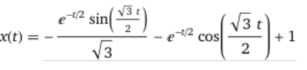

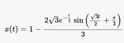

Control system Laplace
Chocolatecat
Jan 22, 2025
4
how to obtain x(t)
Attachments
  • Screenshot 2025-02-20 175111.png
    Screenshot 2025-02-20 175111.png
    17.6 KB · Views: 20
Wow! it looks like homework; what will you do the day of the exam?
Good to share your work and explain your difficulties.
Try this calculator, others available.
You may want to use Laplace transform
Solve the equation for U[t]=1 and x(0) =x'(0) =0
well known curve for linear system.
Pierre
Last edited:
I worked this out and my solution to this is x(t) = -(t^2)/2 +2t - 2 +2.e^-t. Dont see why you'd have problems with solving this.
Where exactly do you need help with this ?
Last edited:
A tutorial to support your query,
Note:
In your case, consider 2nd order autonomous differential equation.
Pierre
Last edited:
Pierre, nothing comes up on this OP's previous thread search now
yeap George, just asking for an answer and marks..
Pierre
