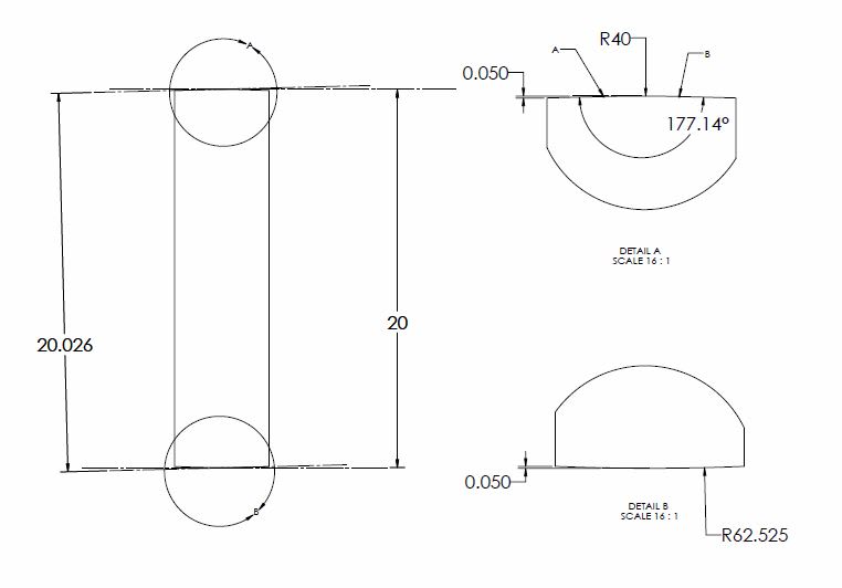

Is something like the below what you had in mind? The bottom surface has constant curvature while the top surface is curved in the middle between points A and B, and has two inclined planar surfaces on either side of A and B. 2 points of contact is achieved at the minimum separation where with 3 points of contact you no longer have a minimum and the UAME is at a perhaps less than optimal or expected orientation.
Edit: realized I referenced the wrong letters for the points
I may be missing something but I can only imagine that a stable minimum envelope for a width feature will always consist of a tangent plane contacting at least 3 high points and a plane parallel to the tangent plane contacting at least one high point.

In your latest sketch, boundary 20 would not be stable. It would rock around R40 and R62.535 similarly to the "pure" convex feature scenario we were discussing. Boundary 20.026 would have more points of contact with the faces and therefore more stable, and per my interpretation more in line with the specification "so that it coincides with the surface(s) at the highest points."
I disagree. That is the unique envelope of minimum width, so rocking would not be possible without an expansion of the envelope. Earlier examples behaved differently due to greater curvature of the surfaces. This was illustrated and discussed in the 18 Mar 19 16:54 post by chez311.
Contact points between actual surfaces in the real world cannot be counted. Contact points between an actual surface and a theoretical envelope can perhaps be imagined, but I don't see how a definition that involves counting them would be useful.

why do you apply the candidate datum set requirement on a tangent plane where this tangent plane is not intended to be used as a datum? Would also you require validation of the simulated tangent plane according to candidate datum set for the example shown in fig. 6-18? In the context of UAME simulation for a width feature, considering my interpretation that one of the simulated planes should be a tangent plane, I don't see a reason to treat it similarly to a datum plane.
While it refers to a minimum number of points - the above referenced para 4.10.1 as well as the section about tangent planes (para 6.5) which you referred to in your definition of contact with the high points both refer back to Y14.5.1 for rocking/convex surfaces. The minimum 3 points of contact is the ideal case, but as pylfrm pointed out about my example a convex feature (designed to be flat) can have less than those 3 points of contact and still derive a (or set of) canditate datum plane(s) as well as tangent plane(s). To deal with rocking/convex surfaces in Y14.5.1 there are the sections 4.3.2 (planar) that pylfrm noted, 4.3.3, 4.3.4, 4.3.5 (FOS - RFS/MMC/LMC respectively) - these all deal with datum features and there is no other section as far as I can tell which deals with rocking/convex surfaces. Pylfrm can correct me if I'm wrong, but I think this is why the candidate datum concept is being applied here. It makes sense that this would apply to features which are not datum features as well - if a primary FOS datum is referenced the UAME is the envelope of interest - this should be the same UAME (or set of valid envelopes) if the feature was not referenced as a datum. Note that in several of your responses going as far back as your post on 14 Mar 19 03:46 it seems you have utilized similar logic in relating definition of the UAME to definition of a primary RFS datum - clearly the connection is not lost on you either.
Additionally I don't see anything in this definition of candidate datums about number of points of contact defining a more or less valid candidate datum.
pylfrm 28 Mar 19 01:57 said:
In you example, both boundaries of the minimum-width envelope are valid tangent lines. See ASME Y14.5.1M-1994 para. 4.3.2 regarding candidate datum sets for nominally flat datum features,
Thank you pylfrm for pointing this out - I did not make the connection between tangent planes and candidate datum sets until I read this. I was initially responding to Sem's assertion about the number of points of contact, but since your post I'm even less convinced of the need as you pointed out to "count" the number of points of contact.
If the simulation is done with CMM I assume that the number of contact points between a simulated plane and the scanned surface extremities is a parameter in the simulation process, and that is when a definition that mentions the required number becomes useful.
Consider a different case: determination of the maximum inscribed sphere for a set of points. There will always be four contact points, but that's just a consequence of the geometry. It would not make sense for the definition of the UAME of an internal spherical surface to explicitly require four contact points.
I'd apply the same argument to external width features. A definition based on minimization of envelope width seems much more meaningful than one based on counting contact points.
If it is what you meant, why do you apply the candidate datum set requirement on a tangent plane where this tangent plane is not intended to be used as a datum? Would also you require validation of the simulated tangent plane according to candidate datum set for the example shown in fig. 6-18?
I think the candidate datum set definition would apply in all cases where a tangent plane is required (including Fig. 6-18) because para. 2.16 (tangent planes) refers to para. 4.11.2 (datum features) which refers to the Y14.5.1M definition.
What do you think the UAME should be for the feature with coordinates posted 28 Mar 19 01:57?
