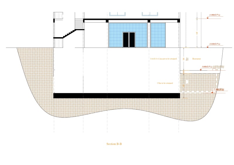

I'm sorry if the question isn't clear. At the right boundary we have this condition. Please find the attached image.
Do you mean for multilevel bracing, at level 0.00 the waler will be 3-sided waler? angled (skewed) side, angled (skewed) opposite side, and left boundary side (3.9m to be retained)?
At level -4.50 the waler will be 4-sided waler: angled (skewed) side, angled (skewed) opposite side, left side, and right boundary side (8m to be retained).

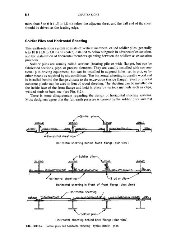

When lagging is installed, there usually is no excavation behind the back flange of the soldier beam. Lagging is usually installed behind the front flange or is attached to the front of the front flange.
Please find the attached image:
This is from Handbook of Temporary Structures in Construction by Robert T. Ratay.
If you look at the newest, 2012 edition of Ratay's book, I am the co-author of Chapter 7, Earth Retaining Structures. There is a lot more info in the 2012 Chapter 7 than in Chapter 8 of the edition you have.
How deep is the existing building on the left side? Is there a basement? If the left side of your Section B-B is that much higher than your right side, you probably cannot use cross braces, unless they can line up with the floor levels of the existing right side building. Even then, the neighbor probably will not allow you to brace to their building. You may need to use inclined raker braces for both sides.
If you cannot underpin, cannot use tiebacks, and cannot cross brace to another building; the project has a major problem - unless you can design very stiff, cantilevered, secant pile foundation walls that will not need temporary tiebacks or braces. This would involve significant redesign of the proposed building.
Although lagging can be installed behind the back flanges of the soldier beams, it is not done very often, except maybe for the upper few feet of the beam where the lagging may need to be removed and the top of the beam may need to be cut off. Soldier beams are usually designed as being fully supported in their weak direction y-axis because there is usually soil or fill concrete and lagging on either side of the web. If you lag behind the rear flange, you lose this lateral support and you will need to use lower allowable stress when designing the soldier beam.
I think we need lagging behind the rear flange not to lose lot area. Does that mean pre-loading will be non-beneficial? Can corner struts and horizontal cross struts be used without pre-loading? My thought is that pre-loading can be applied by calibrating the pre-loading jacks after each lagging phase to engage the passive condition. Am I right?

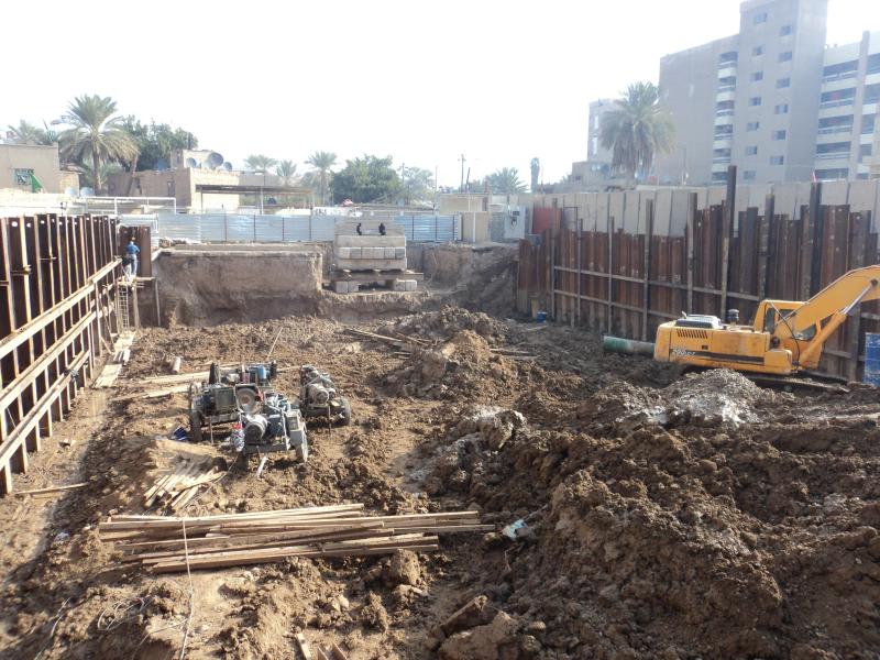

@ hoshang
we seamed to be in working at the same region, send your info to my email
---> lazem02(at) gamil and will help you out as much as possible ...
check following picture of similar work i did before
