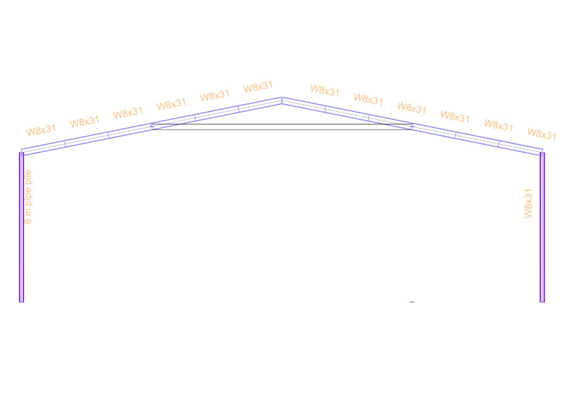

Hi all,
I made a preliminary soldier pile layout as in the attached file (not designed yet) at the elevations in my earlier post. Some struts are longer than 13m. The right and left boundary would be soldier piles braced by rakers. Your thought would be highly appreciated.
 https://files.engineering.com/getfile.aspx?folder=b34b1cc4-0cdd-4d8e-88f4-75514d48f850&file=Soldier_pile_layout.pdf
It would be nice to know the soldier beam spacings. My first impression is that, for holding up buildings, the W8X31 soldier beams are very small and the 8-inch struts are very small and very long. The struts need to be designed for axial load and bending from self weight and any surcharges. In addition, where will your lagging be installed - behind the front flanges or behind the back flanges? Are your struts inclined raker braces or horizontal cross braces? How are you providing lateral support for the sheeting walls along Col. Lines A and E? Is there sheeting at the bottom, angled side of the site from Col. Line A to E? How will the site be excavated with all of those long, closely spaced struts? You need help from someone with extensive, successful, sheeting and underpinning design experience.

Thanks. I'm trying to understand whether my thought is correct. My thought from my post on 5 Jan 24 08:55 came to my mind as I read other threads here recommending struts not longer than 13m. Isn't my framing model for the struts bracing the soldier piles applicable? If not, I wonder why?

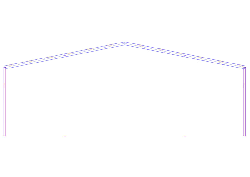

I do not understand your strut sketch. Nothing is labelled. Don't you need soldier beams on all 4 sides of the excavation? Are you trying to brace the soldier beams with a truss? Will you have more than one level of that type of bracing?
Sorry for that. Please find the attached image.
Yes, I'm trying to brace the soldier beams with a bent frame (rather than a truss) if the struts (in the attachment in my post on 4 Jan 24 18:38) are longer than 13m.
If necessary, then it would be a multistory of this type of bracing.
Hi PEinc,
my proposal on the last post is same as would be for a steel structure frame resisting wind pressure (rather than resisting soil pressure). Is this simulation reasonable?

My Final query: is my proposal on 6 Jan 24 09:50 doable?
PEinc said:
your multi-level, segmental, truss brace scheme is both unbuildable and uneconomical.
Why my truss brace scheme is unbuildable? Can you elaborate more on this, please?

I seek the difficulties in building my truss brace scheme you posted here:
I have limited options here since we don't have the underpinning & tieback option. The cantilever soldier pile with this height (8m) must be braced (using either raker or horizontal cross struts). The raker option is omitted since it obstructs the excavation & construction for this limited area. So I have the horizontal cross strut option for bracing the cantilever soldier piles. Since the horizontal cross struts are longer than 13m, I proposed my truss brace scheme. I wonder if one can explain the difficulties in designing & building my truss brace scheme so it can be solved or proposing other options available.
Your truss brace scheme: too big, too heavy, too many pieces, too many connections, needs lateral bracing between trusses, takes up too much vertical space between floor levels, bracing is difficult to remove as floors are being installed.
Braced walls are not cantilevered walls. The sheeting walls will be low, cantilevered walls only until the upper level of bracing is installed.
For 13m long braces, try walers with horizontal pipe braces between opposite sheeting walls. Sometimes, long cross braces need some vertical and/or lateral support to reduce their unbraced length. Install horizontal, corner braces at sheeting corners. This will be easier to build if the new building walls are about 1m off the sheeting walls (the 1m space will need to be backfilled before removing bracing). If you cannot underpin the building, make the sheeting system very stiff and use drilled-in soldier beams, walers, and braces at every other soldier beam. Do a pre-design and a pre-construction survey of the existing buildings and monitor the buildings and sheeting walls during construction.
Again, I ask, why don't you discuss this project with a local contractor who might bid the project's SOE/Underpinning? It does not matter what you design if you cannot find someone, with great experience, to build it.
