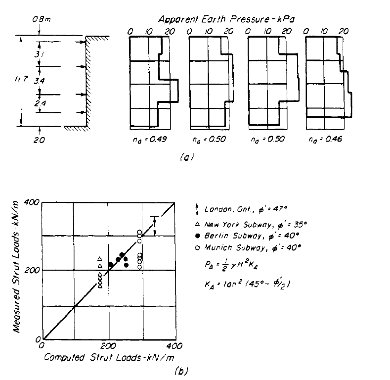

Terzaghi & Peck developed their empirical earth pressure diagrams using a hinge at subgrade. FHWA and AASHTO show using hinge at subgrade for both single-tier and multi-tier anchored or braced, non-gravity retaining walls, both permanent and temporary, with granular or cohesive soils. Ask you colleagues for a reference that is less than 30 years old.

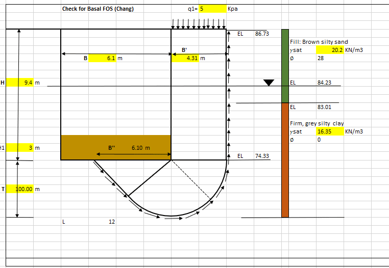

To clarify, I am mostly interested in a one level of support system. The failure mode for those systems is by a big sliding circle (same as slope failure) as opposed to the failure mode of a multi level support system (a vertical column of earth going down and then pushing on the imbedded part of the shoring system upwards- see picture). for the one level of support assuming a hinge for soft clay might not agree with the failure mode.
For your other point, I understand Terzaghi and Peck just 'ignored' what happens below subgrade when establishing their apparent earth pressures.

You are talking about bottom heave in soft clay, which can happen regardless of the number of bracing or tieback levels. I am not in my office and don't cutrrently have access to T&P. Their empirical rectangular and trapezoidal earth pressure methods assumed a hinge at subgrade. Get your ground (hinge) reaction and then design your soldier beam or SSP embedment.
