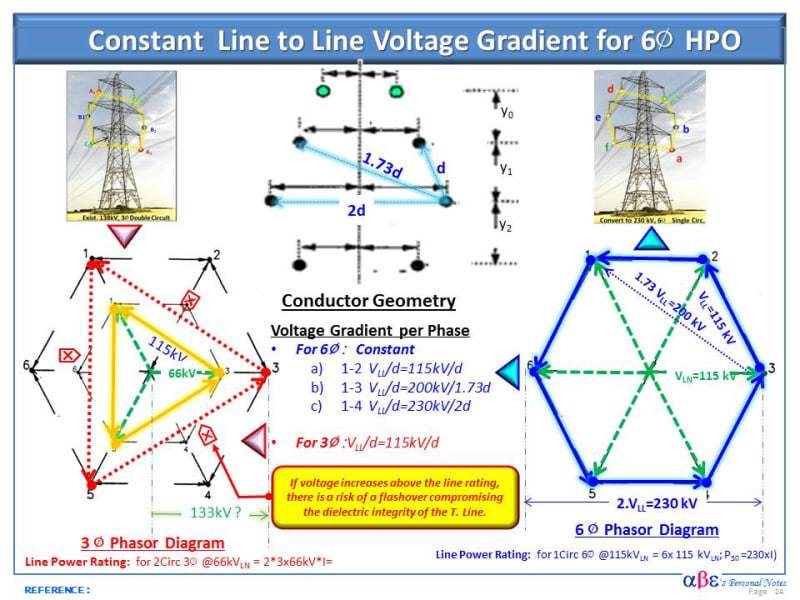

I have not delved into the minutia of this, but I'm not seeing how the phase-phase voltage of the 6-phase line could equal the phase-phase voltage of the 3-phase line without increasing the phase-ground voltage. Once you have to reinsulate, and respace the supports, of the existing structures I'm not seeing an advantage of doing this rather than just running two circuits at a higher voltage. Besides, with two 3-phase circuits I can trip and clear a ground fault at only a 50% reduction in capacity. Put all 6 conductors into a single circuit and that one ground fault now removes 100% of the capacity.
Cuky2000,
It increases the capacity of a transmission line by making it so you can pack each phase together. It is a spacing issue I believe and not a thermal limitation of the conductor. The voltage difference between each phase reduces as you include more so you can pack them tighter together. If you had infinite phases, you would have a cylinder that you would be sending a rotating field down. I suppose there are application for this to be useful but probably only a few would justify all the added equipment. There is a guy from I believe from AEP that has a short video explaining this. It never went any further because load growth never increased as they had expected in their projections in the 1970s.

The phase to ground voltage can be increased in the 6 phase system without reinsulating and re-spacing the support. The cost for the additional work in the substation will determine the breakeven distance in a similar fashion than the HVDC project but much lower cost.
For a SLG event, 3 out of 6 phase can be tripped an even reclosed in a similar manner than a double three-phase circuit. IPO circuit breaker could be used if necessary.
Below is a simple geometry exercise indicating that a constant voltage gradient can be achieved in an existing double-circuit configuration.

I do believe that the HPO is a viable option particularly to up-rate the power capacity of an existing double-circuit configuration.

And oh, I know I'm nit picking- but the line you used in your pictorial example looks like a 400kv line from the UK.

HPO reduces the voltage and the voltage gradients between adjacent phases. That reduces the voltage gradients between the adjacent phases and reduces corona losses.
Hence the corona limit is raised and the phase to phase voltage may be increased.
