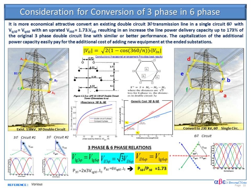

Cuky, your graph shows the thermally limited power density as proportional to the number of phases.
eg: The thermally limited power density for six phases is twice the thermally limited power density of three phases.
Six conductors is carries twice as much as 3 conductors or 200%.
But the surge impedance limit is only 173%
Not quite as good as two three phase circuits.
They converted two circuits and got 173% of the capacity of one three phase circuit.
200% as much conductor and more expensive towers for a 173% gain?
I admit that there may be an advantage in restricted right of ways, but why use special expensive towers for a 173% gain when you can use twin circuit towers for a 200% gain?
I admit that there may be lower impedance when the conductors are in a hexagonal arrangement but that will be offset by the added impedance of the delta wye transformers.
In a relatively short time the industry gained a 173% advantage by changing from delta to wye distribution.
Now I am told that industry is turning their back on another 173% gain?

Thanks for your post challenging the viability of the High Phase Order (HPO) benefits particularly with the economics associated with this type of conversion. Although no very popular, HPO is one of the only few options available to increase the line power transfer capability without changing the line’ This could be valuable in any part of the congested power grids where permitting of new lines are virtually impossible to obtain without count how expensive can be a project. Here is an attempt to answer some of your inquiries in the following posts:
Let's clarify: If the phase-to-phase voltage remains the same for the 3 and 6 phase system, the power capacity of both system remain identical. However, if the phase-to-ground voltage and the rated current is the same in both systems, the phase-to-phase voltage on the 6-phase system could be increased up to 173% allowing the line to be up-rated up to the same ratio. (see sketch below for illustration)
The characteristic of the line needs to be considered. Short lines will operate in the thermal rating while longer lines will be derated and will be driven by the Power Delivery capacity dictated by the Surge Impedance Loading –SIL (MW). Upgrading a line from 100% capacity to 173% capacity without changing conductor, towers, obtain permitting, ROW acquisition, with similar or better performance for me, this is a great deal particularly in areas with a congested transmission corridor. The additional cost of equipment in the substations easily can be compensated by the extra delivery capacity.

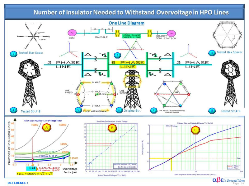

Let's look at six phase on the basis of raised voltage.
Let's consider a wye connected 7600/13200 Volt distribution circuit.
This will have 7600 Volt insulators. Converting this system to six phase will stress the 7600 Volt insulators with 13,200 Volts.
A line generally has more than enough clearance between phases for increased voltage.
The voltage to ground is generally the limiting factor.
Now if the line is 13200 Volts delta, or 13200 Volts resistance grounded wye than the insulators must be rated for 13200 Volts to ground.
With 13200 Volt insulators installed the line may be converted to six phase without over stressing the insulators and gain the 173% advantage.
Or it may be as easily be converted to two grounded wye 13200/23000 Volt lines, for the same 173% advantage.
The delta to wye conversion from 2400 Volts to 4160 Volts was done hundreds and possibly thousands of times for the same 173% advantage.
Phase to ground flash over is more likely than phase to phase flash over.
Show me a six phase conversion with existing plant that does not increase the phase to ground voltage.
A six phase system must be solidly grounded, else a line to ground fault will cause an over voltage to ground on three of the six phases.
An ungrounded or resistance grounded system will be insulated for phase to phase voltage rather than phase to ground voltage.
With a six phase system one of the disadvantages will be the loss of the ability to limit earth fault current with a neutral impedance.

Hi Bill,
Yes, the main advantage of the HPO is to allow raising the line-to-ground voltage by a factor of 1.73% as well increasing the phase-to-phase voltage resulting in overall gain up to 73% the power delivery capacity of the line without investing a dime. All the changes will be in the substations.
Will be great if you can share your thoughts on how to do that in an existing line without major modifications.

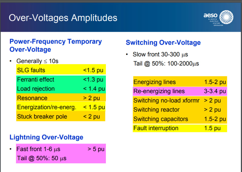

Regarding your early concerns of overvoltage do to the ground fault, here is an excerpt from the AESO in Canada regarding the overvoltage amplitude factors indicating that SLG is not the most severe stress on the line. Lightning and switching are the driving factors selecting the number of insulators for a power line. Below is a sketch with additional information.

In an exiting double circuit T. Line rated for 115 kV line-to-line, will be possible to operate it at 230 kV line-to-line?
Back at you.
In a 115 kV line to line circuit the line to ground voltage will be 66 kV.
In a six phase line this will be increased to 115 kV to ground.
The line to line voltage will not be 230 kV in either the six phase conversion nor the three phase conversion.
The line to line voltage will be 200 kV (198.95 kV)
If on a particular line it is not possible to raise the line to ground voltage by a factor of 1.73, then it will not be suitable for a six phase conversion.

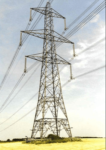

Look at an existing double circuit tower, the conductor arrangements and the clearances.
Between each phase conductor on the tower there is a ground point.
The phase to phase clearance is twice or more of the phase to ground clearance.
The phase to phase voltage is 1.73 times the line to ground voltage, not twice.
