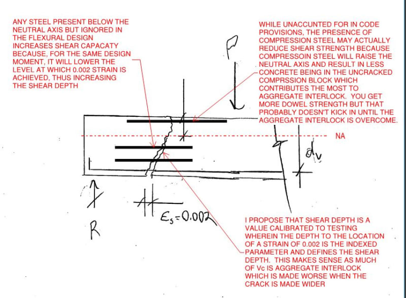

I have some thoughts to offer on the interplay between flexural reinforcement depth and shear depth. Please refer to the sketch below.
SOME PRELIMINARIES
1) Note that, in reinforced shear design design, we take Vc in the cracked concrete member to be the same value as Vc in the uncracked concrete member. That's a bit weird when you ponder it as one case is elastic-ish and the other is cracked/plastic.
2) If you look around at the various shear provisions for slabs, beams, plain concrete, and prestressed concrete, you will often find alternate definitions of the shear depth that are independent of the location of the flexural reinforcement. 0.8h and things like that.
3) In my mind, #1 + #2 = shear depth is a parameter that is indexed to shear testing rather than being a "pure" variable in the physics / mechanics of materials sense that it might be under elastic stress conditions. The cracked, plastic condition is very different animal.
MY CONCLUSIONS
4) Rebar located below the neutral axis but not considered in the flexural design will not reduce the shear depth. In fact, it will increase it per the sketch below as, for the same design moment, it will lower the location of 0.002 tensile strain.
5) A far more robust definition of shear depth would be "the depth at which tensile strain reaches 0.002". I believe that such a definition eliminates most of the sources of confusion that arise from the usual code definition of shear depth.

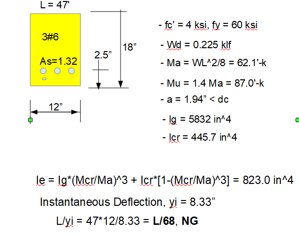

An example problem to demonstrate the effect of a beam with too shallow a compression block (a < dc).
Problem statement - a 47' long simply supported, singly reinforced beam subjects to self weight alone. Find whether it satisfies both strength and service criteria. (Please double check my calculation for mistakes.)
Strength Check: Vu = 7 kips, ØVc = 8.8 kips; Mu = 87'-k, ØMn = 86.3'-k, say ok.
Equations for Icr calculation.
What may I ask are you trying to demonstrate/say/prove with this example?

If you are asking me, you didn't read the opening statement, which I stated clearly the purpose/cause it to serve. With a compression block such small, the beam faired badly and fail service criteria, though it satisfies the strength requirement. But there is a catch, that the example has violated an important rule in design, I think some one would get it sooner or later. Let's see.
You stated the purpose it was supposed to serve, but it doesn't serve that purpose. The deflection is not excessive because the depth of the NA is to small, it is excessive because the section is not stiff enough for the span and load. If you halved the strength of the concrete the ULS neutral axis would be well below the cover depth, but it would not reduce the deflection under SLS loads, it would increase it.

You still don't know what you are arguing about. After hardbutmild posted the stress-strain diagram on 25 APR 20 22:35, I posted several comments to point out the invalidity/absurdity of that odd condition, that is, the NA located above the supposedly compression steel. The reactions/responses I received were not very positive/receptive, thus I addressed it again on 26 APR 20 02:34:
Secondly, IMO, the neutral axis shall not be allowed to be above, even near, the compression steel, since the concrete is not confined, the nominal compressive stress can not be sustained/achieved. Although the so called code requirement on balanced strain condition is satisfied, failure is a sure thing, so something definitely needs to be done to meet the demand - further increase compression capacity and maintain moment capacity, preferably increase beam depth.
Then on 26 APR 20 03:08, I questioned:
I am also curios that will that beam satisfies deflection/service criteria, with cracked section properties, not to mention long term effect.
Without receiving any response, I created the example just to point out the fact that there was something fundamentally wrong that led to hardbumild posted condition. I am glad that it draws your attention. As your response serves as the confirmation of my persist concerns and comments, but you probably did not realize it.
Yes, in real design, it (NA above compression steel) should not happen, and would not occur, since any engineer with basic training will begin his/her design with a beam depth selected in accordance to code recommended span/depth ratio, thus, in normal circumstance the deflection will not be excessive, because the implied adequacy in section properties and rigidity. But, it seems sometimes people are not taking that check (span/depth ratio) seriously as an important first step in design, then weird situation does occur.

You should just give up when you are behind. Your example is nonsensical, much too shallow for the span, and the neutral axis location has little to do with it.
Hokie66,
I don't quite understand why I was "behind".
I purposely made the example up to demonstrate what is the consequence when compression block is too small, which should never occur. As you correctly pointed out, the smallness of that block was caused by not having adequate depth from the beginning, the mistake rendered the stress-strain diagram drawn for that condition, and the calculation, all waste efforts. A lot of discussions were made un-necessarily after my comments made on 26 APR 20 02:34, which was replicated on comments above.
But you are right, I've stated all I've to say. It's time to stop this non-sense. Thanks.
