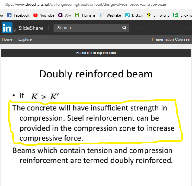

Below is the reason I've doubt on the value of this type of design. Something needs to be done if neutral axis is at, or above the top face steel, as it defeats the purpose to have compression steel, and creates uncertainties.
We are not talking about if the concrete has insufficient strength here. That is the condition whereby a singularly reinforced beam won't satisfy the code is if the balanced strain conditions are not satisfied. This triggers the use of compression reinforcement to reduce the neutral axis depth to below the balanced strain condition. If you are unable to put compression reinforcement within the balanced strain neutral axis depth, well then its hardly compression reinforcement is it! (noting this might be depending on ultimate limiting strain of the concrete and yield strain of reinforcement somewhere in the region of 0.3-0.5 times the member depth, so is unlikely to be above the reinforcement put at the extreme compression fibre in practical terms)
If the reinforcement being added to get to the doubly reinforced condition isn't carrying compression, then you still fail the balanced strain condition. I'd note here, you still need to satisfy the balanced strain condition even if you add compression reinforcement. The act of adding some reinforcement in compression is not enough here, you still need to check the neutral axis depth satisfies your relevant code provisions.
No something doesn't necessarily need to be done, unless of course you are failing the balanced strain conditions. Lightly reinforced beams will rarely have the compression block depth deeper than any top reinforcement. This is irrespective of whether this top reinforcement was considered in the strength calculations or not. From a balanced strian perspective if this check works with a singularly reinforced check, then its clearly going to work with consideration of any reinforcement in compression.

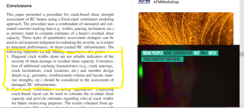

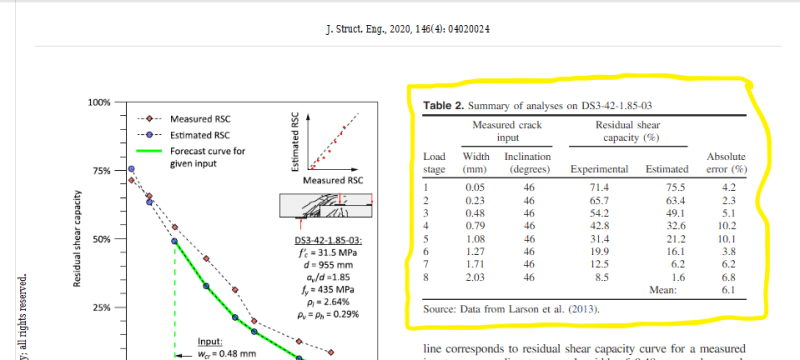

I've not seen research or codes indicating that flexural cracking would impact concrete shear capacity. It's usually not even visible.
Neither do I. The most close study I can find is a paper published on ASCE Structural Engineering Journal, Link, dated January 2020.
Note in the world of "shear", everything is uncertain and inconclusive. Conservatism and prudent in design shall prevail.
Below are excerpts from the article.
