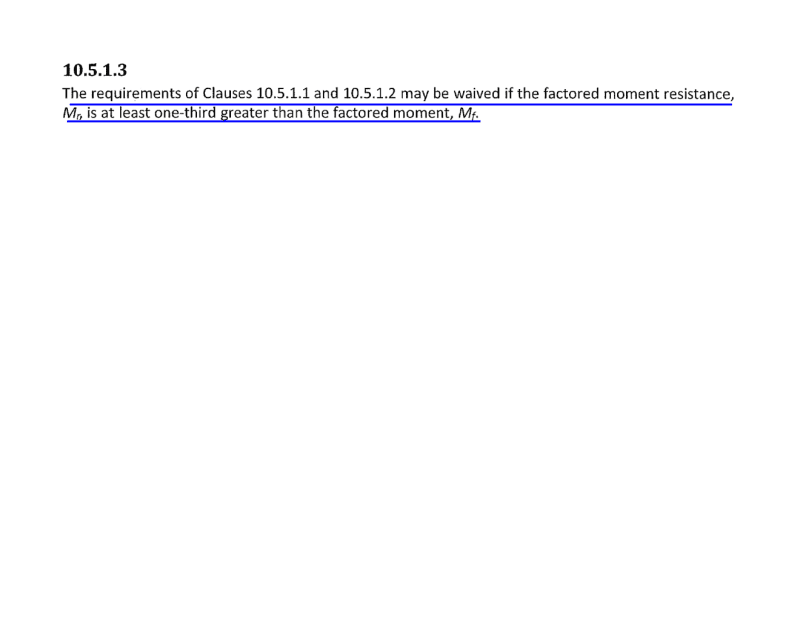

It from CSA A23.3 (14) I don't do much concrete stuff and this is the latest copy I have,

As (minimum) - this is the minimum reinforcement required to ensure that you have a ductile failure. It typically is derived from the beam size, not loads - except for the standard proviso that dik mentions where the codes allow you to simply increase your steel 1.33 times above your required steel based on strength.

Under the minimum flexural reinforcement (As,min) then check that provided is what, 50% more than the amount required by analysis and below As,max?
ACI has a provision for that similar to what was mentioned for CSA (Canada?).

Yeah I don't know the provision but now that more neurons are working, if I recall correctly it's 4/3 of the reinforcing that is required by analysis is the alternate minimum, so it might be justifiable that way. Unless that's only for development length.....

ETA: I may have invented a provision here, I haven't found it yet.
I did locate the 12.5.3.4 - Excess reinforcement which has a proportional reduction for "excess reinforcement" involving development length, although that can't be used blanket to reduce the development length below a minimum length.... anyway. I'll keep poking about. For whatever reason I'm looking at the ACI 318-95.
ETA: Found it.
Source: ACI 318-95
That's what happens when I text search for 4/3 and the language is "at least one-third greater"..... even looking for "required by analysis" I was getting despondent.
