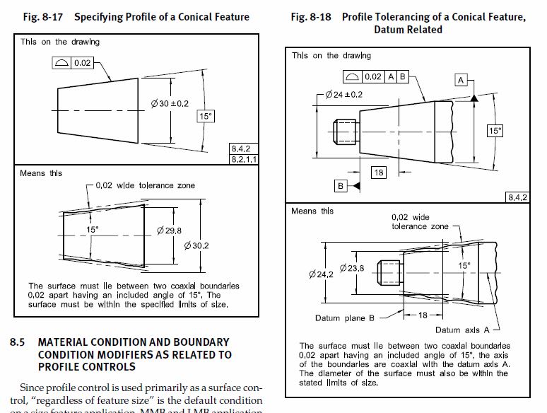

CH - I don't mean to stir the pot, but do you take issue with the below examples from the standard? It seems to outline a pretty clear cut method for utilizing profile on a conical feature which I don't think would be much of a stretch to apply to flat tapers.

Please search this forum for fig 8-18 and sure you will find different opinions regarding it. I know it is from the standard but not everyone is in agreement that this fig is the best thing that 2009 standard has.
Also in the next y14.5 revision (now draft) this 8-18 figure is going to be "adjusted"-replaced by a new one (with delta modifier) and, hopefully, all disagreement will be gone.
greenimi - I did a quick search and found a few threads discussing this topic in depth, I'll definitely be reviewing them at length but safe to say I did not mean to derail this thread into that discussion. It seems the topic is much less cut and dry than I initially thought it to be.
Consider my questions regarding profile controls of conicity/taper and 18-8 retracted!
