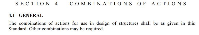

Pretty much. Though I don't see the pressing need to separate A and B in this case. The Eurocode makes a common sense approach of considering favourable and unfavourable loads explicit other codes are less explicit. You still just need to use good engineering judgment on what is favourable and what is unfavourable and also any additional combinations that may be rationally required.
The AS code quite clearly says this though leaves it for the engineer to figure out:
1732561482268-png.1482
