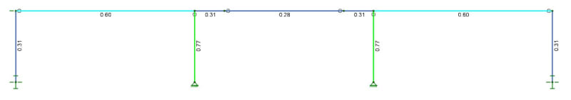

DaveAtkins
Unity check with column fixed to beam:

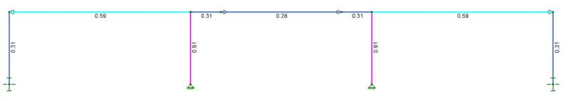

Unity check with column pinned to beam (restraint added to make frame stable):
So if moment to the column is considered it definitely increases the unity check.
DaveAtkins
14% difference in unity check seems reasonable to me. In reality, it is somewhere between fixed and pinned, so call it a 7%± difference between designing as pinned or fixed (situation specific).
Designing everything to a .9 code check covers this differential and just changed my mind on how to design it. A lot less effort to design it as pinned, and designing to a .9 code check would likely cover the difference in forces for a scenario very similar to the one you have shown. Great work, Dave.
Soooo...assuming pinned connection is unconservative.
