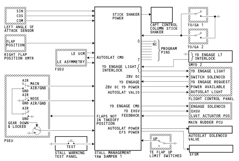

If your interested someone changed the method of securing power control units to racks from rivets to fast fasteners on the production line. These fasteners don't give a grounding bond to the airframe.
Don't have a clue what the implications of that are with the electrical system, I am sure Lou and Bill does though.
Well if the electrical system is built with the same principle as a car, which it seems to bee looking at this picture.
Where all minuses goes via the ground and not via separate cables back to the power source.
Then the problem becomes the same as having a a bad minus pole or earthing in a car.
Anything can happen and things just stopp working.
What this "fast fasteners" are I am not shore, the word can probably be used for a lot of different rivets, screws etc.

They are push and turn to lock type clip there is a T on the end of the shaft which goes through a hole with a slot. You then push against a spring and turn and the T then has metal under it and holds them in.
Well that's what they usually are for cowls and fairings. Avionics Usually has threaded lock bars which get tightened to keep the connections good in the rack then wire locked so they can't move.
I think the anything can happen is the reason why they have stopped them flying before the FAA has had time to produce the official paper work requiring it.
To note this is the power distribution not the flight control system although as you say it may screw up everything.
Okey I know what you mean, we have those kind of fasteners on some electrical cabinet doors.
There was talk about a fire hazard.
So my guess is that if the unit isn't tightened enough, there can be discharges and light arcs, causing fire.
