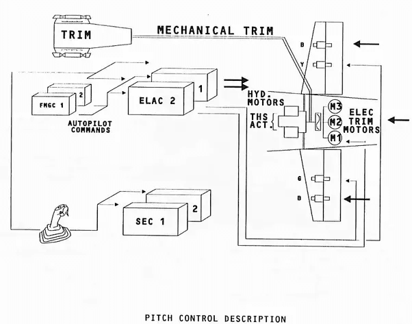

The AP will let the plane into high angle of attack, but when the stick shaker triggers it then should dump the whole lot onto the pilots to sort out when the AP cuts out. Well in theory because in these the AP stayed in with the stickshaker going which also needs dealt with.
How to get the AP to command high Alphas is easy you just put it into VS climb mode and set a high rate of climb and don't do anything, eventually the plane will stall and kick the AP out. The altitude you stall at depends on the rate of climb. If you use the level change or ASI then you have protection. You can also get it in ASI mode if the pitot tube is blocked to the active ADC supplying info to the flight director when that happens the ASI turns into an altimeter and the aircraft will pitch nose up to try and maintain a fixed airspeed which will always increase with altitude so the nose just gets driven higher and higher until the stick shaker goes off. Then your dumped with an aircraft with about 40 degs nose up with full power on and full aft trim.
The airbus has a different setup. 737 is a single electrical screw jack. 1 actuator.
Airbus is 3 separate electrical motors then the mechanical trim feeds in from the front (two sets of steel wires one down the left of the aircraft one down the right). This then feeds into twin system hydraulically assisted screw jack one of which is powered by the redundant third backup hydraulic system that's powered when the RAT is out and the other by the one of the main hydraulic feeds. So triple redundancy on the electrical side of things and dual redundancy on the hydraulic, dual on the mechanical linkage. Full range of elevator travel is available to the pilots at any speed or any degree out of trim via the manual trim wheel.
I believe the 777/787 has a similar setup.
