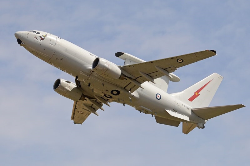

I'd bet a few $$ that Boeing was leaning on the MCAS to stabilize the MAX without adding the two 'draggy' wide-ventral-fins that were added onto the 737AEW&C [E-7 Wedgetail], lower-aft fuselage.
It appears these wide-span ventral fins were added to this 737 variant to enhance aero-stability at extreme-AoA due to [mostly] destabilizing effects of the 'wide-blade' antenna on the upper-aft cabin... on what 'looks' like a shorter body 737
Regards, Wil Taylor
o Trust - But Verify!
I've always wondered at how few control and stabilizing surfaces were on commercial airliners. I'd imagine that there are many stability and safety benefits to various unused stabilizer technologies and control surface redundancies that could make airframes an order of magnitude safer. I'm sure it is mostly due to matters of fuel efficiency which is a sad trade off.
