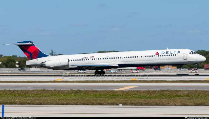

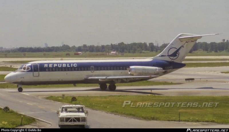

I have to agree with Alistair Heaton that sometimes the desire to remain under an old Type Certificate can go to great "lengths". If you take a look at the two attached photos, you will see the beginning and the end of the DC-9 line. They are both under the same type certificate. The "only" differences are stretched fuselage, re-designed wings and entirely different engines. Other than that, they are identical! [That last statement was pure sarcasm - the interiors and the flight deck are entirely different as well.]
 https://files.engineering.com/getfile.aspx?folder=d55a151e-af49-4045-9645-9e0111bafb0f&file=DC-9-88_or_MD88.jpg
debodine: Just use the
to directly paste your pictures into a thread. Do resize them down to around 1000 pixels wide.
Keith Cress
kcress -
"Other than that, they are identical! "
We call that a California remodel; so long as a single wall from the original house remains, you can demo the rest of the house and quadruple its size and it's not a new build. That seems apropos, since Douglas was a California company.
