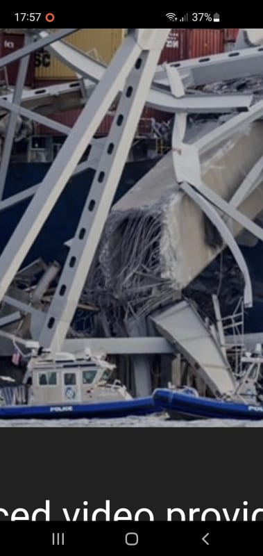

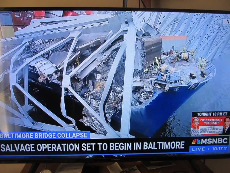

I snagged this picture off a news broadcast last week. It's an incredible mess they're dealing with, and it looks like the bow was just abraded away in the collision. That big block of concrete must be part of the bridge support. I'm surprised to see such a clean break on something so massive.
This photo from earlier makes it pretty clear those towers were hollow section reinforced concrete. So OK in compression but not really very strong when hit by a ship.

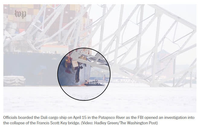

The FBI boarded MV Dali this morning, opening an investigation and preempting the NTSB and Coast Guard investigations, according the the Washington Post. The FBI is being tightlipped about what they are looking for but the Post imagines it to be about the crew setting sail knowing there were system problem aboard.

I bet that ladder seems 10X longer than it actually is when stepping off the little boat.
Why the FBI and not USCG?

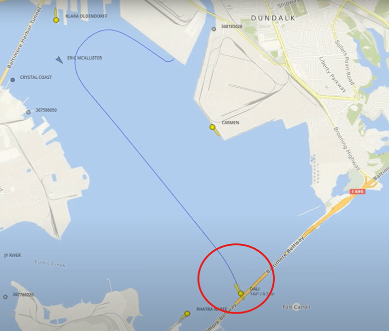

I'm trying to plot the precise path on CAD of the MV Dali in her last mile of so to show it be consistent with the path of a ship with a rudder locked in position, possibly a hard left. I can get approximates location from videos online but does anybody have the AIS data the videos were based on? Or know where I can get the data? AIS data has precise location and heading information that would be helpful in proving or disproving the rudder-locked-position theory.

I'd be careful about how you interpret the AIS data. It's good for giving other vessels a general overview of the traffic around them, which is its primary purpose; but is not designed or intended to be a high resolution and rapidly updating trace of a vessel's movements.
There are many factors which would have influenced the ship's heading after power loss. If the main engine was not powering ahead, the rudder would have quite limited influence on the ship's heading; and if it was powering astern while the ship was moving ahead, possibly no influence on the heading. The rudder is only properly effective when the ship is moving and powering ahead; it effectively redirects the ahead thrust of the propeller. The combination of current in the main channel, current from the side channel, and wind could explain the change in heading. The final stages of the turn could also, possibly, be the starboard bow grounding on the shallower water between the main channel and the bridge pier.
If they did go hard astern when the lights first came back on, that could account for the turn after that moment. This was my initial thought from the large cloud of dense black smoke and heading change, but I'm now more 50:50 on it.
Trying to resolve all of the above into a reliable analysis of the rudder position seems like a very tall order to me.
My go to for ships is GCaptain and they haven't agreed on an answer.
