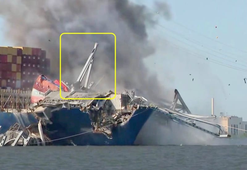

A comment from StreamTime Live chat
microbug said:
WBAL TV just reported that Unified command had to change plans since there were hazmat in the crashed containers, so no charges placed on the upper part of the truss
Is this relevant to anything that happened today, if so what?
I notice a few structural members were left standing nearest the cans and maybe that is what was deliberately left out of the demolition.
I don't see any upwards surge of the bow whatsoever after the bridge section fell away. This indicates the ship is hard aground. There is likely flooding from the hull being gashed as it hit the bridge support. There will likely need to be some unloading of containers before the ship can be refloated.
This is something that should have been known before the bridge section was demolished. The cause of the collision should be known by now. There is zero transparency around this incident. Really makes you wonder who our government works for?
Tug, you seem to imply that the people working on this salvage effort were not aware that the ship was hard aground. OK, let me ask; if they did know that the ship was hard aground, then up to this point, what should they have done differently?
