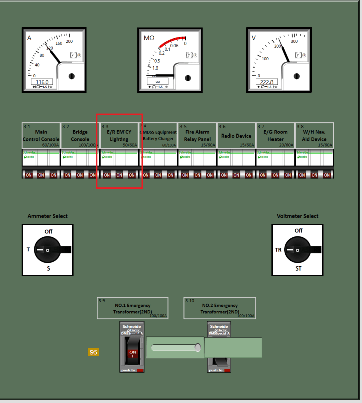

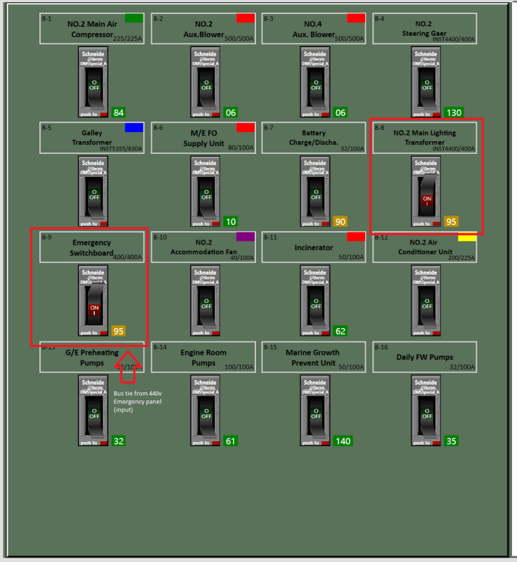

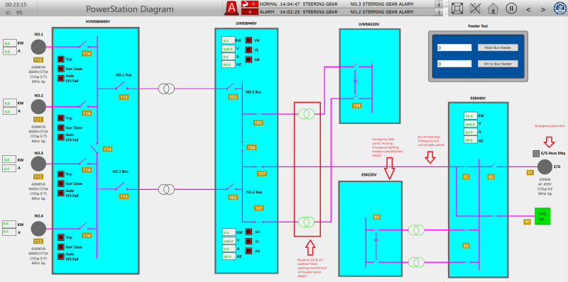

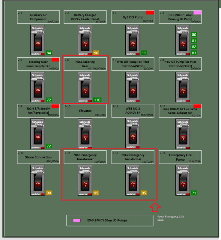

FYI, for those who are interested, there is a Chinese (I know, might not be the best source, obviously download at your own risk) ship simulator/trainer that one can install and experiment with, located here:
It is free for some of the ship models, but requires registration (I used one of my throwaway email addresses).
It seems fairly comprehensive, although some of the ships simulated seem to be broken/incomplete (I've been trying for days to get the entire AC electrical system up on their "Steam Turbine Powered LNG Ship ERS," for instance. I'm at the point of suspecting that there is a bug in this one, but I could be wrong).
Anyways, they have a simulator for "ULCS (10020 TEU) ERS" that I'm assuming is SOMEWHAT (basically same size class) similar to the ship in question, although I'd expect that the exact wiring details/installed equipment would vary per individual ship.
In this simulation, the only lighting circuits on the emergency bus are some engine room emergency lights. The main lighting panel (seems to be LVMSB220V) derives it's power from a 440v normal power bus, through a 220v transformer (actually a pair for redundancy).
You can drill down to each panel/etc to see and control/simulate the actual breakers, so the above diagram is only a top-level view.
Detail from the 440v emergency switchboard:
Detail from the 220v emergency switchboard:
Detail of half of the Normal 440v switchboard:
Of course, the question is, how close is this to the layout of the MV Dali?
