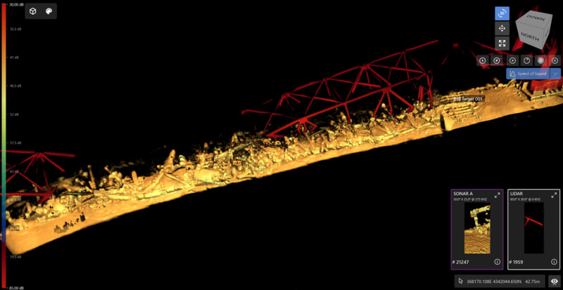

That image appears to be a composite of an above water lidar scan and a below water sonar scan. The depth in the channel is 50 feet deep, giving a sense of scale as to the size of the parts that are still in the air.
The detail in the sonar portion is impressive.
Genuinely impressive - although the difference in resolution (<2 ft in the sonar portion) coupled with the yellowish colouration makes it look as if the structure has been underwater for twenty years.

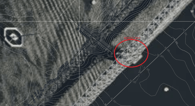

I brought in the available lidar data into CAD last week. Here is a screenshot of the contours referenced to NAVD88 (US FEET). There's a deep depression just northwest of the bridge pier that I'm assuming is part of that utility channel cutting SW to NE.

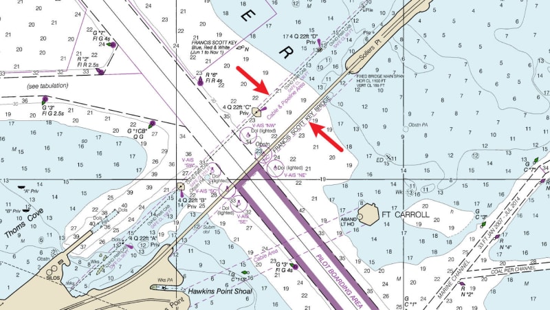

Looks like the NOAA charts don't show the exact location of the gas pipeline. Just a generic "pipeline and cable area":
