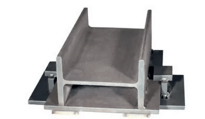

Hi, I am trying to specify some pipe hold down hardware and it has to be Anvil. Looking in the catalog linked to below (see p.67)....that looks like a good product. Only problem is: these don't have the side load capacity I need. (They've got about 2/3rds of the capacity I need.) I'm not very familiar with Anvil's products.....can anyone recommend a alternative?
The 439 is limited to 10 inches of travel along the axis of the pipe. The piping designer needs to verify that is enough, and if not, are travel stops allowed.
