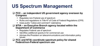

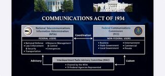

In Typical Government fashion, FCC controls civilian spectrum, and NTIA controls Government Spectrum. The two agencies coordinate shared spectrum.
