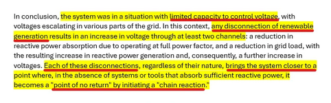

Primary frequency control and the discussed loss of power factor control are closely related, Attached is a paper "
Primary Frequency Response and Control of Power System Frequency
Prepared for the
Office of Electric Reliability Federal Energy Regulatory Commission
Principal Author
John Undrill, John Undrill, LLC
Energy Analysis and Environmental Impacts Division Lawrence Berkeley National Laboratory
Chapter 9 discusses primary frequency response
While the inertia of the system is the dominant influence on the initial rate of decline of frequency, it is far from a dominant influence on the frequency at which the decline is arrested.
The speed of governing response is a strong influence on the nadir at which frequency is arrested.
As I understand the situation with inverter power supplies, grid following inverters do not have any "Governing response" while grid forming inverters have various degrees of programmable governing response. Compare this with the throttle response of a machine with a conventional governor (such as are available fro, m Woodward Governor Company) which has been discussed at great length on engineering tips.
Primary response is then followed by secondary response actions like automatic load shedding, and dispatching.
