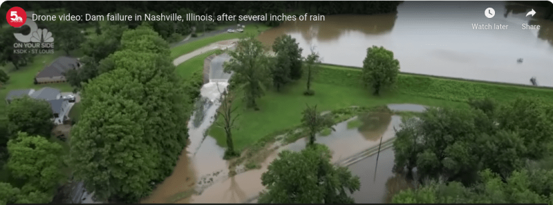

Here we go again. 90 year old earthen dam, with what looks to be a quite small and vulnerable spillway, that is overtopping and warnings of imminent failure.

Risk of Illinois dam breach is under control after once-in-a-century rainfall, officials say Updated 10:04 PM EDT, Tue July 16, 2024
[URL unfurl="true" said:
https://www.cnn.com/2024/07/16/us/nashville-illinois-dam-break/index.html[/URL]]After water overtopped a reservoir dam and forced residents of a small Illinois city to evacuate Tuesday morning amid fears the structure could rupture, local officials now say the situation is under control.
Drone video: Dam failure in Nashville, Illinois, after several ...YouTube KSDK News Jul 16, 2024
In this case the emergency spillway was present and appears to have worked as intended.
KWQC Jul. 17 said:
https://www.kwqc.com/2024/07/17/amid-heavy-rainfall-southern-illinois-nashville-dam-system-breached-hundreds-evacuated/[/URL]]The 90-year-old city reservoir, which provides Nashville’s drinking water, includes a main dam with a spillway and a secondary earthworks dam. The design allows water to breach the secondary dam, diverting overflow to protect the main dam, said Alex Haglund, a spokesperson for the Washington County Emergency Management Agency. The “fuse plug” spillway that activates during high water levels directs water along a designated emergency path, IDNR added.
After action report July 19;
Video July 19 KSDR -
Conclusion - the emergency spillway worked, during a rain event that appears to have significantly exceeded the main spillway capacity. Given the dam is 90 years old, I give the owners a "Good Job".
