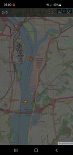

These are from pprune.
Looks like the helicopter was high and maybe got confused with which aircraft was which.
Also a late change of runway for the CJ. PAT25 is the helicopter.
Do military aircraft have TCAS transponders?
Even if they did, they are apparently disabled below 1500 or maybe 900 ft. The jet was on finals at about 350ft.
This does look like a failure both of ATC protocols in that area plus ATC failure.
There is a distinct possibility the helicopter pilots didn't know which aircraft was which as one was taking off just before the other landed on the cross runway.
Really only the ATC / tower controller can see all the aircraft at the same time.
Looks like the heloicopter was following "Route 4", which amazingly crosses the final approach path into runway 33.
There's also a video floating around of what looks like ATC radar with CA (Collision Alert?) flashing away for several seconds.
No idea if this is true or not, but you can then also see the second plane landing on runway 01 on finals.
