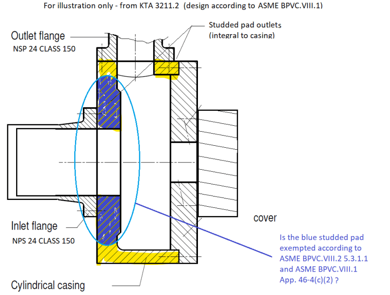

for an ASME BPVC.VIII.1 "Design By Rule" designed pressure vessel, we conduct a supplemental analysis along the requirements of Appendix 46, 46-4 DESIGN BY ANALYSIS (using the methods of ASME BPVC.VIII.2 Part 5).
One of the components of the numerical model is a Studded pad type connection designed to Div. 1 Subsection A General Requirements PART UG (i.e. UG-43(d), ...). It is not of welded construction (it is integral to the pressure vessel).
As for 5.3 PROTECTION AGAINST LOCAL FAILURE, Div.2 5.3.1.1 states "[...] These requirements apply to all components where the thickness and configuration of the component are established by using design-by-analysis rules. It is not necessary to evaluate protection against local failure (5.3), if the component design is in accordance with Part 4 (e.g., component wall thickness and weld detail per 4.2)."
Div.1 APPENDIX 46-4(c)(2) requests "[...] The exemption provided in Division 2, 5.3.1.1 is applicable to weld details in Division 2, Part 4 only. There exist weld details in Division 1 that are not permitted in Division 2 [subject to the provision in 46-3(f)]; those details are not exempt from evaluation of protection against local failure.".

Best is a drawing, and more info: material, design pressure and temperature.......etc.
Regards
I agree that a drawing would be best to assist you. However, if you are choosing the design thickness of a component using Appendix 46-4 because there are no rules in VIII-1, then you component detail is likely not exempt.
Dear @r6155, dear TGS4,
thank you for interest in my question and your replies.
I indeed did not and do not intend to design the thickness with DbA. The dimensions have been assessed with UG of Div.1. The DbA is done as a supplement to the DbR.
The DbA run is not to assess this particular component (studded pad outlet); this component is present in the numerical model in order to obtain correct limit conditions for the rest of the model.
Here is a simplified representation of the location of the component in the complete model:
Ummm....
Lateral view?
General dimensions, material, design pressure & temp. ?
Regards
You 'sketch' makes your problem as clear as mud.
It barely looks like a Pressure Vessel.
I would treat this similar to a pad flange, where the blue area is a reverse loose flange (or maybe a reverse integral in this case) per VIII-1 Appendix 2, then check the holes to UG-43(d) and (g). I would also do an area replacement check on the opening and limit the radius so it doesn't go into the tapered section, also remove area for the tapped holes. That keeps you in VIII-1.
However, with the flange connection on the top of the picture, I'd say just do an FEA.
To answer the OP's original question about whether this component would be considered a "standard" component and therefore be exempt from evaluation of Protection Against Local Failure - my answer would be no.

Dear r6155, DriveMeNuts, Cobra17, TGS4,
thank you for your interaction, answers and questioning.
Our design follows the ASME BPVC.VIII.1 design by rule calculations, taking into account the Reverse flange (Appendix 2), Opening (mainly UG-36, UG-37, UG-40 (fig UG-40 (a-2)) and Method of attachement of pipes and nozzle necks to vessel walls UG-43(d) Studded Connections, and (g) Tapped holes engagement length rules.
We do the FEA calculation mainly for the top opening, when we cannot move it away from the main body flange.
[ul]
[li]However, because of this sentence "The exemption provided in Division 2, 5.3.1.1 is applicable to weld details in Division 2, Part 4 only" my main question is still to know if, of all components, only welds are exempted; or if the same exemptions apply, except for Div.1 weld details which are not covered in Div.2? [I am not a native english speaker][/li]
[/ul]
@r6155, I'm all right, thank you for inquiring [bigsmile]. As I mentionned on the drawing, the illustration is for illustration only, I used it so that eveyone can have a glimpse of the general geometry of the design. We are not working for nuclear/atomic indsutry.

Dear @r6155,
I greatly appreciate your concern, however I will restate that this illustration if for your information only:
I don't want to disclose my company's drawings therefore I used this image because the general arrangement of the components is the same.​
I don't want to mix codes; as you may have noticed, that is the purpose of this thread, in which I asked about the wording of ASME BPVC.VIII.1 MANDATORY APPENDIX 46 RULES FOR USE OF SECTION VIII, DIVISION 2, 46-4 DESIGN BY ANALYSIS with regard to ASME BPVC.VIII.1 CHAPTER 5.
