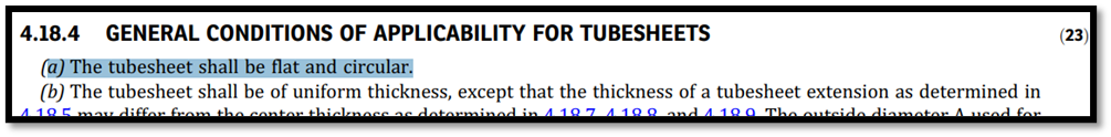

Not sure if I am being clear or not. Let me rephrase my questions & background.
fixed tubesheet heat exchanger, config. b, tubesheets integral with shell, extended as a flange and gasketed on the channel side.
Q.1 Is it valid to assume the non-circular tubesheets to be a circular and design the thickness using sec.viii div.2 part 4 para 4.18.8?
Q.2 if the above assumption can not be used, my only option is sec.viii div.2 part 5?
Q.3 if at all for any situation we end up using FEA to “design the thickness” of a component, do we must abide by sec.viii div.2 part 5 rules? i.e checking for all failure modes. Not just elastic analysis.

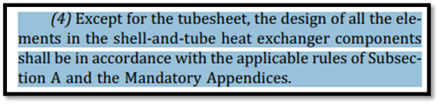

Keep in mind that you do not have a Division 2 vessel, but a Division 1 vessel which needs to be desgin by the design rules of Division 2 (because of the change in Part UHX).
That doesn't mean your vessel is a Div. 2 vessel.
If there are no design rules in Div. 2 than U-2(g) applies and Part 5 can be used (among other options).
A.1 - No, that doesn't seems reasonable to me.
A.2 - No, you have other options, see U-2(g). But, if FEA is chosen then Part 5 shall be used.
A.3 - See App. 46.

1. As per Sec.Viii Div.1 UHX-1(a)(4) -
understood and abiding.
2. As per Sec.Viii Div.2 4.18.4(a) -
Since my tubesheet is non-circular, the design rules from 4.18 can not be applied. so reading 4.18.1 scope.

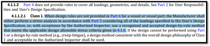

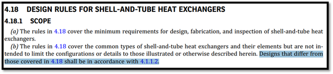

3. As per Sec.Viii Div.2 4.18.1(b) -
understood and reading 4.1.1.2.
4. As per Sec.Viii Div.2 4.1.1.2-
understood and as per above, I shall perform FEA in accordance with Part 5.

My understaing is that because you do not have a Division 2 vessel, but a Division 1 vessel.
For a Division 1 vessel you do not care about 4.1.1.2.1/2 and when no design rules are available you go to U-2(g).
This means: When design rules are neither given in Division 1, nor in Part 4 of Division 2, you apply U-2(g) and use another generally accepted method or FEA in accordance with App. 46.

In your step 3 - where you reference 4.1.1.2 - you need to stop and read UHX-1(7)(b) first.
UHX-1(7)(b)The rules in Part UHX cover the common types of shell-and-tube heat exchangers and their elements but are not intended to limit the configurations or details to those illustrated or otherwise described herein. Designs that differ from those covered in this Part shall be in accordance with U-2(g) in lieu of 4.1.1.2 referenced in 4.18.1(b).
UHX-1(7)(b) says that you shall go to U-2(g). Now, if you choose to use U-2(g)(1)(-a), which points you to Appendix 46, then you end up in the same spot. However, it doesn't preclude you using U-2(g)(1)(-c).
