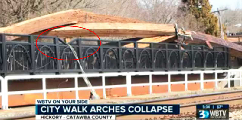

spsalso
"Another source of additional tension on the lower arch cable may have been from the cable crossing the railing on the bridge..."
Looking at the first photo posted in this topic, it appears to me that, by the time the cable could have moved to intersect the bridge railing, it was all over.
A strange thing: I just did a search on Bing for "hickory north carolina bridge collapse" in images. There were none for this event. I wonder how that came to be. Google came through.
spsalso
which is to say that the cable failure was not a cause of the collapse but a result of collapse --> behind door number 2

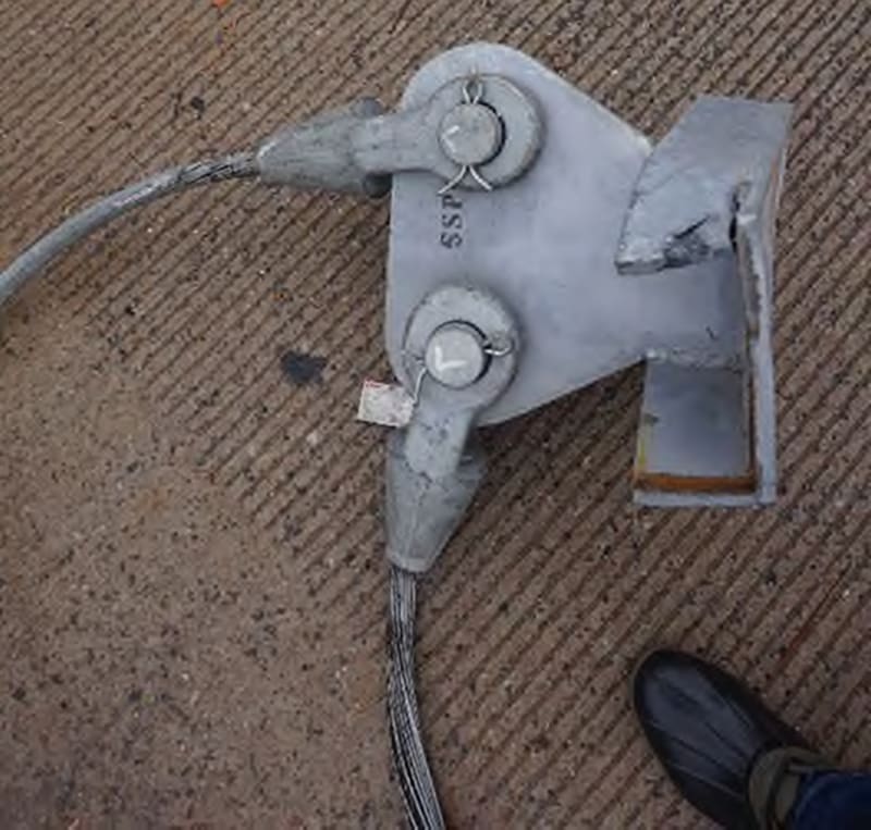

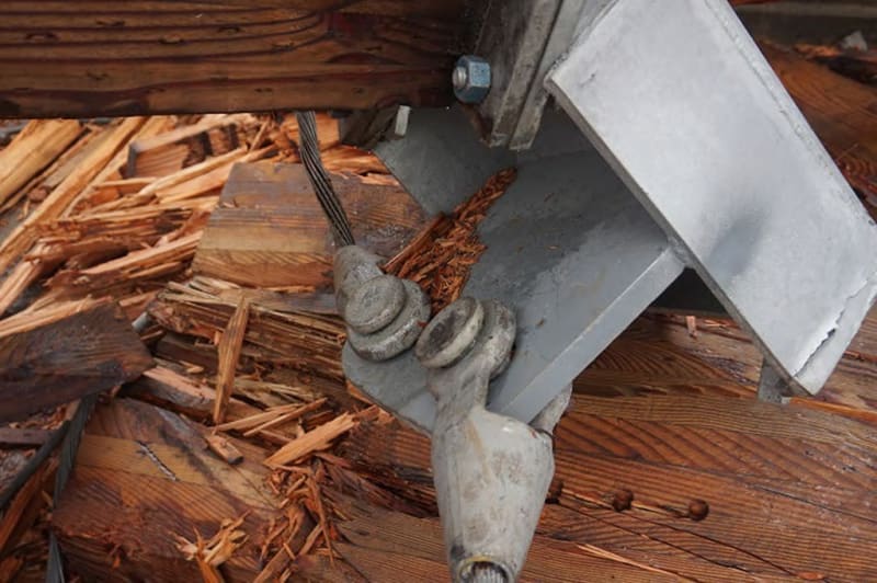

A revision to my previous post copied here.
Edit 2 - I see now how the second bolt hole (in the lower cable bracket connection) was utilized. The north side of the timber bracket is bent underneath the debris and would have been provisioned with a second attachment point. My comment on the welding is still in play. It seems like there is ample linear space for a robust weld connection so it brings into question the quality of the weld. Also with regard to the bolt connection, why the slots and did the bolts work themselves loose?
I find the comment that someone decided the cables were rods, and could then work in compression pretty hilarious. Just how much compression can you put into a 7/8" rod that is maybe 50' long before it fails and bends? Or bends and fails.
spsalso
It is difficult, perhaps impossible, to define exactly which elements failed first, and which were destroyed by the impact, etc. In addition to the crazy looking joints, another thing struck me. A lot of those 'anchor bolts' just pulled cleanly out. The concrete bits seem not to have suffered much, but the bolts popped right out. Straight bolts, no anchorage. Were they chemical anchors or expansion anchors?
Edited and corrected again as I misidentified the orientation of the second image.
Birdcaging of the wire rope at the socket may be a clue to the sudden release of tension or indicative of other issues? It appears more pronounced in the south rope which had significant tension failure. Of course when the structure fell, the north rope would go completely slack so perhaps this is evidence of the structure flapping in the wind prior to its collapse or cycling during its short life span.
The upper arch south north cable also exhibits significant birdcaging at the upper socket which would indicate that it was abused as well likely prior to the fall and in another image it is seen to be sharply kinked upwards at the socket so it likely sustained this damage from the fall.

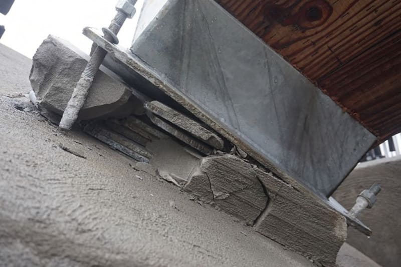

Threaded rod epoxied in place but I doubt I can call it accurately from a photo.
So far, all of the anchor bolts I've seen have pulled out of the drilled holes rather than pull up any concrete so it would seem that they did not develop their intended strength. This may be a moot point given the base was entirely more stable than the upper portion.
Photograph 9
Looks like a bunch of stacked shim plates under a relatively thin base plate, with a bit of grout to make it look pretty. Not a base detail to engender confidence.
They are so lucky that they didn't maim or kill anyone. I bet they are still doing their laundry, if they didn't just burn it.
The base plate installation is pretty interesting.
The photo 9 one has some shim plates surrounded by grout to support the base plate. The photo 11 one does not. It is extremely unlikely that the designer would spec two different styles of mounting, one with and one without.
So it appears that the mounting shown in photo 9 came up 3" short (photo 5), and filler was added. I suspect discovery of the need for this modification was made during the physical installation of the arch itself. It does not reek of prior planning.
Study of the photos shows that the hold-down bolts were not an additional 3" longer where the shimming was used. From photo 9, it appears the exposed hold-down bolt was engaged in about 3" of grout and 2 1/2" of concrete.
I have little experience in gluing bolts into concrete, but I do wonder whether the "glued-on stuff" (of about a 2 1/2" length) is concrete dust that was never blown out of the hole.
I question whether the grout is "Structural Grout". Which means that, structurally, it isn't there. So it would contribute nothing to pull out strength for the bolts. In addition, it would provide nothing for lateral movement. As I said, structurally, it isn't there.
I am sympathetic to doing an install, and finding the "bridge" is 3" shorter than the needed span. But this looks incredibly poorly designed. As an experienced electrical worker, with all the knowledge that that implies, I would have at least made the steel shims the full size of the base plate, and cut bolt holes through them. I would have added additional large steel blocks on all four edges to minimize lateral movement of the stack. And I certainly would have used longer bolts.
I am SO looking forward to finding out how this one "solution" turned out to be needed, and was so designed. I note that the Dara Thomas, the investigating forensic professional engineer, made no mention of the above in the report.
One additional point: for the base plate in photo 4, I question having two of the hold-down bolts located so far away from the location of the landing of the wood beam. Works OK for lateral, but pull-out???

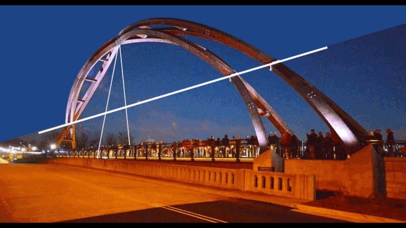

I do a lot of stuff that is unusual... I thrive on it. I take great care in understanding the system to start with, and try to keep up with materials. Although not common, there was nothing distinctly different from a normal structure. Something was likely overlooked and not taken care of. I suspect it was the geometry... but don't know for sure.
The cable and geometry may have contributed. The effect of the cable may not have been as good as inticipated.
It would be neat to see actual detailed drawings of the arch and connections.
The breaking strength of 7/8" steel cable is 31.1 tons.
The 1:5 vector ratio means that 6.2 tons of sideways force at the top anchor would break it:
12,400 pounds.
Subtract from that the "pre-tensioning" done by tightening those turnbuckles at the bottom. I wonder what that "pre-tensioning" figure was supposed to be and how it was achieved.
Once one cable is caused to snap, presumably by wind load, then the "pre-tensioning" load on the other side will add into the wind load that just caused the other side to snap.
Doesn't sound good!
