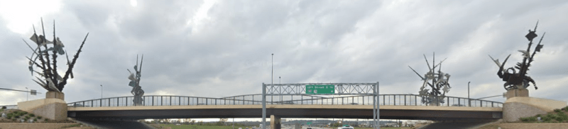

Steel sculpture? Maybe they can hire the guy who made this for Council Bluffs, IA:

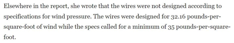

There's something else at play here... I would not normally expect this to be a cause...
According to page 8, the contract/design called for 35PSF while Western Wood Products only designed for a '32.16' PSF load. I'm not sure it specifics anywhere what the practical cable strength is/was, that I can see anyway. Edit: I kind of doubt a beefier cable would have saved this design regardless...

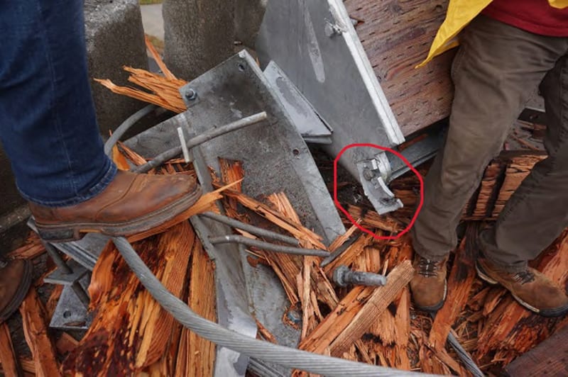

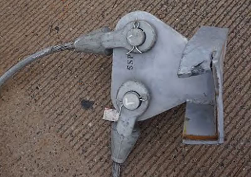

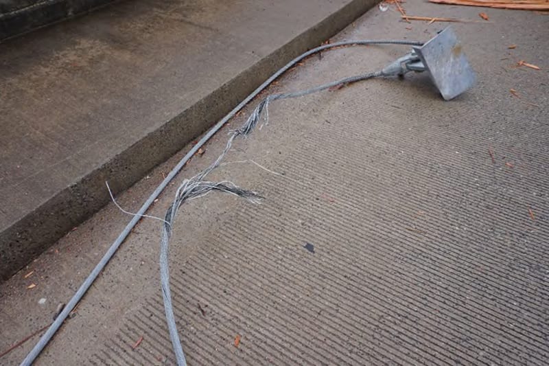

So the lower arch cable attachment is suspect. The cable attachment bracket was attached asymmetrically with one bolt in the center of the lower arch. What?!?! The cable itself became frayed but stayed together while the welded bracket failed (not much weld visible either). There is no information regarding wind events that this structure experienced during its brief two month lifespan though a dump of local significant events for 15 years prior is provided. Did this cable fray solely in this event or was the damage initiated in prior events?
Edit: Was the bracket attached/welded only on one side ???? Answer: Not likely
Edit 2: I see now how the second bolt hole was utilized. The north side of the timber bracket is bent underneath the debris and would have been provisioned with a second attachment point. My comment on the welding is still in play. It seems like there is ample linear space for a robust weld connection so it brings into question the quality of the weld. Also with regard to the bolt connection, why the slots and did the bolts work themselves loose?

Obviously it shouldn't matter, but keep in mind this particular report was specifically initiated to hold harmless the Neill Grading and Construction Company. I believe there is at least one if not two other groups doing an investigation as well for the other parties involved.
Regarding the welds, I'm kinda surprised the confidence level is high enough to claim they failed while in the air vs the damage in question being the result of the twist and then impact. The area(s) in question clearly had a rough landing.
