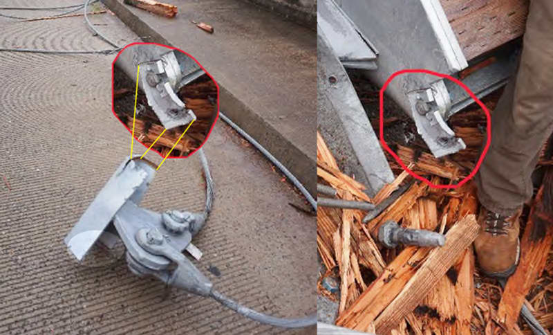

It is a bit alarming to me that nearly every picture containing steel exhibits welded joints that have pulled or cracked right at the root/HAZ.
If that rusty line on the inside edge of the loose twin socket bracket was where another piece of steel was butted prior to galvanizing, it does not not look like there was any fillet penetration whatsoever.
Edit: Not implying this is a trigger/cause. Perhaps a quiet indicator of a much larger issue...
I agree, welding is poor everywhere. As for the connector, it looks like it was continuously welded on one side only, possibly so that protruding weld did not interfere with the fit, lest costs were incurred for further prep or grinding. The counter argument is that when the structure collapsed, these connections were going to be destroyed one way or another.

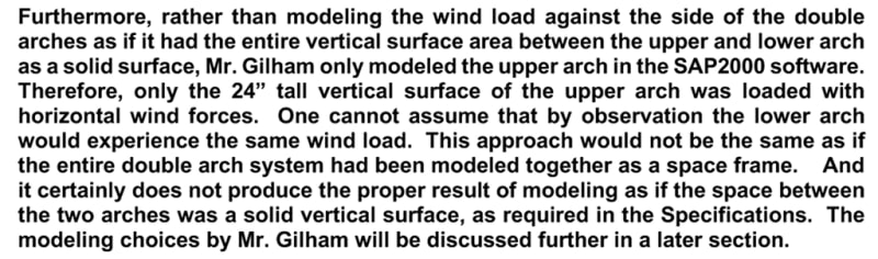

From a design aspect, the report touches on an interesting aspect, modelling for wind load. It appears that wind load was considered for each arch standing separately but without consideration for any proximity to adjacent structures, in this case a twin arch immediately adjacent.
Page 8
I wouldn't be the least bit surprised if the engineer who ran those calculations learns of the '35psf on the entire profile as if it's a solid wall' requirement from the forensic report. I would be even less surprised if they said they concluded the design was completely infeasible with that wind load within other parameters of the project, and so chose to reduce it based on engineering judgement. I get it...modeling it as a solid wall is a bit silly...but it also doesn't fit nicely into any of the categories for wind analysis that structural engineers typically use. So to reduce it without a more rigorous testing method (such as a scale model in a wind tunnel) isn't the best move. No doubt they felt the budget pressures...wind tunnel testing on a $750,000 structure? When pigs can fly...
