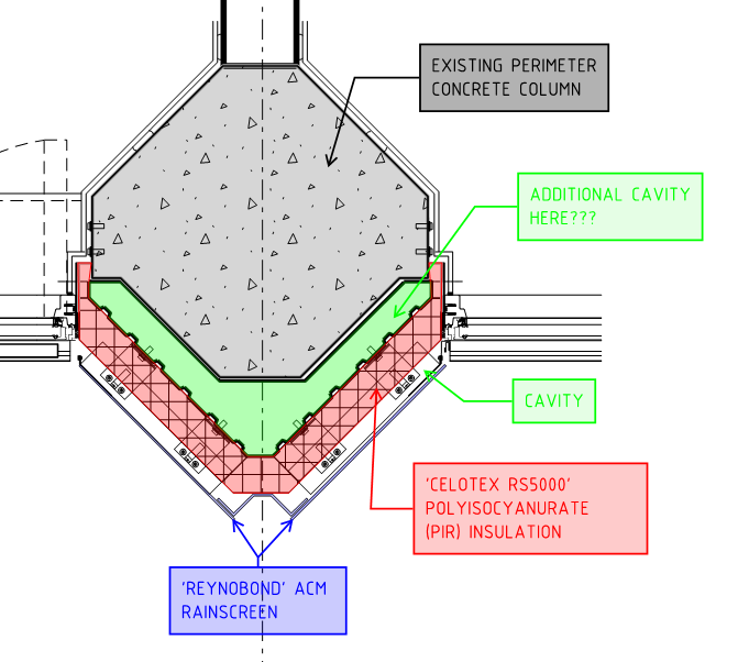

I wonder if the deep corrugations on the column allowed flames / air to pass up the inside of the insulation
I think you may be correct. Looks like they used cold-formed steel to offset and attach the PIR to the existing column exterior, and creating an additional cavity: Plan-section of detail:
Ingenuity (Structural) - The green area in the section drawing with the note: Additional Cavity Here??? is representative of the concrete columns from the 3rd floor to ground. The green section from the 4th floor up represents the precast concrete fascia attached to the poured-in-place concrete columns. Either the precast concrete fascia was never added to the lower floors or it was removed sometime over the years. The original planning supplied by the architect for the refurbishment suggested a brick exterior on the lower floors but some other kind of fluted fascia was placed instead.

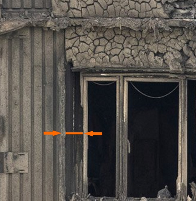

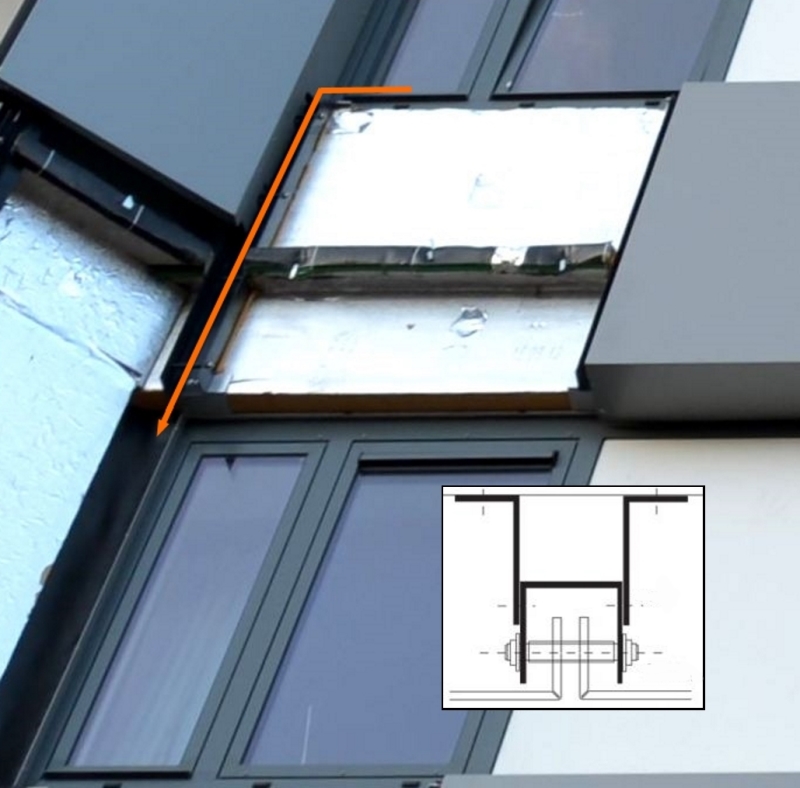

This seems to be the route of ingress of fire debris behind the cladding. The cold-formed steel hangers for the cladding form a boxed U-shaped channel. As flammable debris cascaded down between the gap between the 4th floor Column ACM cassette/panel & the Spandrel ACM cassette it would have channeled much of the debris to the inside of the 3rd floor Column ACM cassette. I'm speculating that the black material along side the insulation, is window flashing with a bituminous composition. Some of the flammable debris would have landed on the bottom of the forth floor Spandrel ACM cassette (3rd floor window soffit). So the "Hook & Pin" method of ACM suspended cladding installation created a vulnerability.
The window frames did not extend column to column. The vertical edge of the window frame stopped 6 inches or more from the columns. What was used to fill in this void is anyone's guess but it is this design attribute that compromised the compartmentalization of each of the flats. The use of, what I assume, is a ?rubberized/bituminous? window flashing, primed this void with a material much more flammable than the Reynobond Polyethylene ACM or the Celotex PIR Insulation board. The composition of such a material is a mixture of: Heavy Paraffinic Distillate Solvent Extract CAS# 064742-04-7 , Petroleum Asphalt CAS# 008052-42-4 & Styrene-Butadiene block copolymer CAS# 009003-55-8. The HMIS - Hazardous Material Identification System used on Material Safety Data Sheets, identifies such a composition as having a Fire Rating of 1. (Slight Hazard Materials that are normally stable, but can become unstable at high temperatures and pressures.) It has a flash point around 210C and, if left exposed, would be the most vulnerable material in the assembly.
The design decision to use the ACM Column cladding as the vertical edge of the window opening, doomed the safety of the interior of the flats.

dik (Structural) - I don't disagree. For the contractor, it comes down to the windows. They were able to use the same left hand & right hand windows on all 4 elevations by staying with just one size. It violated the Environmental Planning done with respect to natural lighting as set forth in the commissioned BREEAM study but it was less money, maybe.... The building required a total of 294 windows on the upper 21 floors. Instead of buying 84 Left-hand Windows & 84 Right-hand Windows, sized for the North & South elevations AND buying 63 Left-hand Windows & 63 Right-hand Windows sized wider for the East & West elevations. They bought 147 LH & 147 RH windows all of a smaller size. So it seems, they adjusted the volume of the column cavity to accommodate the uniform window sizing.
epoxybot - excellent drawings, pictures and commentary and it has been a thing I struggled with as well which was of course the outside cladding shouldn't catch fire and spread like it did, but even so how did it catch the whole building like it did and enter the flats as quickly as it did. Gaps around the window frames filled with something very combustible was my thought and this seems to give weight to that theory.
There was something very odd / different with those columns though which may or may not be replicated on long vertical sections on other buildings. Your picture in the post of 16 June 21:28 is still the most dramatic and alarming of the whole sequence leading to this appalling loss of life and injury.

LittleInch (Petroleum) - I think the Fire Inspection team already know that the gap between the window frame & the columns was the path of fire entry inside the flats. A number of photos from 2 days after the fire show fire inspectors (or possibly Structural Engineers) taking numerous photographs, principally focused on the column areas of the structure. This very large scale photo shows how intense the fire was at the columns. Link

It is too bad we do not know where the refrigerator was located, though photos of other fire ravaged units suggest it may have been close to the window. Knowing now that the window frames do not extend to column, it raises the question if the fire damaged the wall at the column/window frame interface, inside the flat. What the tenant of the 4th floor flat can tell regarding the actions of the Fire Brigade, the resulting damage, if the window was open, or the kitchen exhaust fan turned on and the location of the refrigerator will be interesting.
