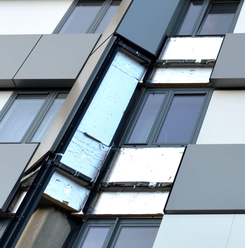

Question: Would have a non-flamable cladding, installed above a flamable insulation have made a difference? I think not, the cladding would still generate the chimney. Am I wrong?
AFAIK some styrodur insulation are flamable but extinguish when no other fuel is present, then the material of the cladding would be very relevant. Maybe I missed among all the talk about the cladding what kind of insulation was used.
Another question: upthread, and in the NYT article, positive pressure emergency stairways where mentioned. The doors have to open inward, against the pressure. I'd think that maintaining a positive pressure uniformly along the length of a stairwell without the pressure diff locally beeing to high for some people. Likely a solved problem, how is it done?
MartinLe:
I think the problem was the thicker layer of insulation applied to the building with an air gap between it and the aluminum encapsulated insulation... This was the cause of the fire spreading so rapidly... the air gap provided a stack for the flame to quickly progress upwards.

So the original outreach presentation, by Studio E Architects to residents, included two cladding materials VMZ - Zinc/FR-PE Composite & Marley Eternit - EQUITONE fibre cement facade panels.
An interesting factoid is the Limiting Oxygen Index (%) of a given material. The Limiting Oxygen Index (OI) is a convenient test to make preliminary determinations about the flammability of a given material. It is the amount of Oxygen needed to self-sustain a flame. Atmospheric Oxygen at sea level is 21%. I have read values of 23% & 28% as the value needed to render a material non-flame self-supporting. Paraffin has an Oxygen Index of 16% & Polyethylene (PE) an OI of 17.4%. Most of the data on Polyisocyanurate (PIR) is behind "pay-walls" but the most common IO reference I found was 22-23% and one as high as 29%. With such a minimal need for Oxygen, one would think that PE would burn like a candle but its vapor pressure limits its combustion. A caveat of the Limiting Oxygen Index test is that the flame is applied to the sample from above and the buoyancy of the flame, limits the ability of the test to yield real world results. Many of the most fire resistant materials drop by as much as half the OI% when the flame is applied to the bottom of the sample. This is not true of Polyethylene, it remains at 17%. So one can conclude that the vapor pressure of Polyethylene doesn't make it the best combustible material but its low requirement for atmospheric Oxygen makes it a great fire starter. How good a fire starter is Polyethylene? It has a heat of combustion just shy of diesel fuel. Heat of Combustion in MJ/kg: Paraffin 42-46 / Polyethylene 44 / Diesel 44-45.
A likely scenario is that the burning of the Polyethylene creates a heat column sufficient to render any fire resistance that might have existed in the PIR insignificant. Even though much of the Polyethylene melted, the melted PE would have pooled on the firestop blocking between floors. Molten Polyethylene retains a remarkable amount of heat and would have radiated that heat back up the void creating a flash-over condition & compromising the PIR very quickly. At about 900C the vapor pressure of Polyethylene has no deterrent effect on its combustion and it burns like a paraffin candle, completely leaving zero waste product.

I have read at least one news item where the Fire investigators are looking into the possibility that the cladding ventilation gap on the columns may have been greater than that on the spandrel 'cassette panels'. My own eye perception last week was that the cladding ventilation gap on the columns appeared to be the width of a 2x4, so 90mm.

epoxybot - although the columns do appear to have been insulated as you can see evidence on the photos I wonder if the deep corrugations on the column allowed flames / air to pass up the inside of the insulation or whether the insulation in those sections was not as thick. Clearly any fire stops on the columns were useless if indeed fitted and long vertical sections appear to be the clear accelerating element.
LittleInch (Petroleum) - I think the trapezoidal relief feature proved to be a difficult surface for the workers to mechanically secure the insulation to the columns. The insulation charred much like what remains on the spandrel panels but the longer sections of charred column insulation fell to the ground during the fire. The trapezoidal area is about 25% of the surface area of the column face and if char formed on the back side and resulted in some expansion, then it pushed the insulation panels away from the column increasing the air gap & fire until the char collapsed. Here is a good photo of the cladding assembly & the fire stop blocking. On the columns, it looks like the fire stop is all that secures the insulation in place. The horizontal presentation of the spandrel insulation, confinement top & bottom plus the fire stop seem to be what held the spandrel insulation in place, for the most part.
