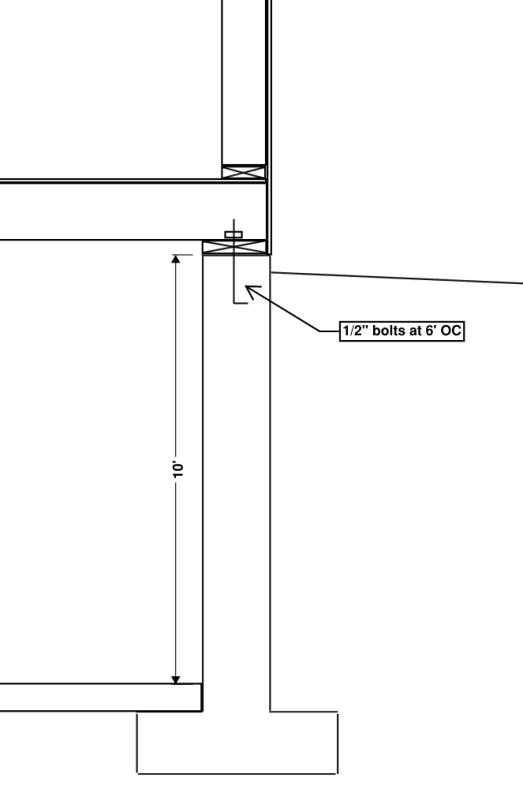

I feel like you're missing a ribbon board on that detail at the joist, Mike Mike, but it's not critical to the discussion at hand.

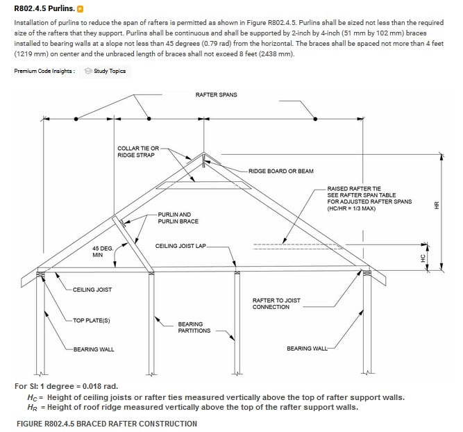

On the 52' span, I suppose, if the rafter table gives you a 52' span, then... maybe? R802.5/1(1) (2000 IRC, sorry, that's the one I have open at the moment, but the other versions aren't insanely different...), is for dead load of 10 psf, roof live load of 20 psf (no snow), and no ceiling (L/180 deflection), Even so, that's a 12" joist spacing, DFL select structural, not something you'll usually get in quantity, given the 26' length you need.
I mean, yeah, for a ceiling joist versus a vaulted ceiling, I suppose, you need a ceiling joist, too, though, which is another DF ss, 26' long 12" on center. I hear rafter span (and ceiling joist span) and I think vertically supported at both ends. Maybe the residential code doesn't come out and say that, the "ridge board or ridge beam" in the drawing sure doesn't mean there's a vertical support (ridge board isn't a vertical support), but the ceiling joist, that's got to be looking for an interior wall at the 26' mark, it's not a clear span. I suppose, yeah. 52' width. I would imagine while there may be tables for the rafter to ceiling joist connection, there is probably not enough space for that many nails. Then we have the splice in the ceiling joist. That is probably going to produce a large force demand that could exceed the IRC fastening schedule, as well.
That kind of bears on the rest of the conversation, if you can put it in, but there's no space for the nailed connection? Table R802.5.1(9) has one entry where 39 16d nails are required for the connection.... that may be enough to make the connection work, but that sounds like a lot of nails in a relatively small space. You can clinch the nails to reduce the number required, but a 16d nail 0.162 x 3 1/2" per 2018 NDS, I suppose for 3" of wood (2 x 1/5") you get the 3/8" length beyond to get a legitimate clinch. (3 diameters past the side member? 12.1.6.4?) 802.3.2 requires a 3" overlap between the two ceiling joists, that's not a lot of space for nailing, at least not for a 26' long rafter each side, R602.3(1) Fastening schedule seems to call for 3-10d nails there. That value never changes regardless of the rafter to ceiling joist connection.....
On the bolt at the top of the masonry wall - wouldn't you need preservative treated wood there for the sill, so DF or SP, not HF?

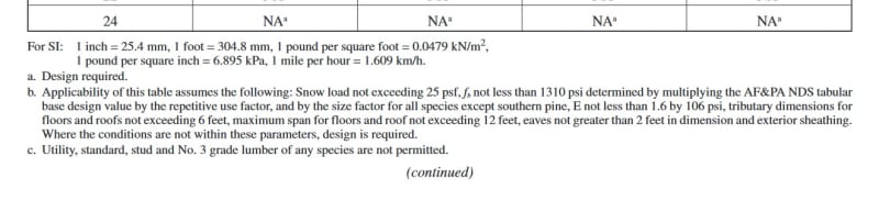

Look at the 2000 International Residential Code, R603.2.1, point one, not parentheses 1. You're looking at a fastening table, the table I'm talking about (back when) was called Maximum Allowable Length (THEY should say height? Okay maybe not) of Wood Wall Studs,.... 100 mph, SDC A, B, C, or D
1 (snow load 25 psf or less.... provided the F
b multiplied by the repetitive stress is 1,310 or more. That's where the MOE requirement was, like I said it might have gotten deleted.
Per
2018 National Design Specification, Supplement:
Sitka Spruce, Select Structural, 1,600,000 psi MOE
Beech Birch Hickory, Select Structural and Grade #1,
Coast Sitka Spruce, Select Structural,
DFL #2 or better,
Hem Fir Select Structural,
Hem Fir (north) #2 and better,
Red Maple #1 or better
Yellow Cedar select structural

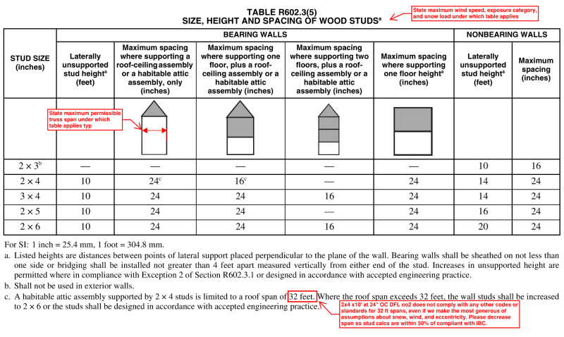

Nothing one usually constructs with, unless you're going to count DF #1 which I'd rather doubt is a typical stud in say, California.
I kind of wonder if you can get a 2x4 stud to work for that 26' span of roof above it. Is that an 8' height, then?

I want to say that the sill bolting at 6' is for the load in the braced wall along the length of the wall (into the page, from wind/seismic). When it comes to the bracing effect of the top of wall versus the retained soil (perpendicular to the wall), the code .. might not know about it. There's maybe other provisions elsewhere for anchor bolt spacing due to the lateral (soil) load with C
D = 0.9 in there somewhere, or the code gives a reaction at the top of the wall that's supposed to be "designed for" (by whom?).
