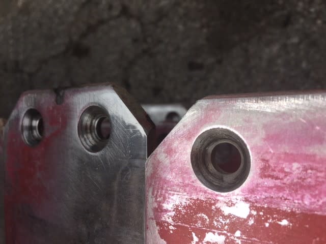

What Type of Hole Provides Better Retention of a Part - Counterbored or Countersunk 9
Finglas
Jan 24, 2009
138
IE
In my head a counterbored hole provides more rigidity as the screwhead has a flat surface to screw up against.
Would I be right in my thinking or is it 6 of one and 1/2 a dozen of the other?

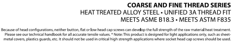

Holo-Krome indicates the following -
There are several advantages to using a counterbore hole, including more holding strength. A counterbore usually has more holding strength compared to a countersink hole because the force applied by the socket cap screw head is parallel to the axis. The force applied by the screw or bolt is distributed evenly over a larger surface area. This is not the case with a countersunk hole, which has tapered sides. As a result, the force applied by the screw or bolt is not evenly distributed, but dispersed at an angle or along the slope of the hole.
Variation on toleranced head angle and countersink angle indicate that there is limited contact between countersink and head. Not to mention surface texture of countersink seat which will burnish under load and vibration resulting in loss of tension.
^ Agreed.
Countersunk screws are rarely used alone or over deep holes, which makes them both difficult to hold tolerances but also ensures that the contact of the tapered seat is never perfect. And if we take a moment to think about that instant when the screw first touches the taper (which is almost always on one side of the taper), then it's clear that further tightening applies bending moment to the head of the screw. That means a good amount of the tensile strength and torque is wasted on forces other than tension.
Counterbored screws aren't without their challenges but they do put the vast majority of their strength into grip force.

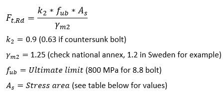

In term of bolt strength according to EN 1993-1-8, table 3.4, the tension resistance of countersunk bolt is about 70% compared to the other head types (by comparing factor k2, 0.63 / 0.9 = 0.7)
Engineering is a journey of thousand miles begins with a single step
Thanks cherish... I didn't know that...
