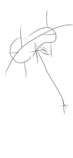

Here is a rough sketch of slotted holes I use for quick instal and removal for fixtures, adapter plates, or top hold down adapter. Allows machinist to quickly install and remove as necessary. 3 or 4 equally spaced273965e9-049f-4f12-aedb-e2dc54c04168.png
These are for soc head bolts. The head slips thru the hole
The the adapter is rotated the tighten down with an Allen head. I made thousands of fixtures with this design.
