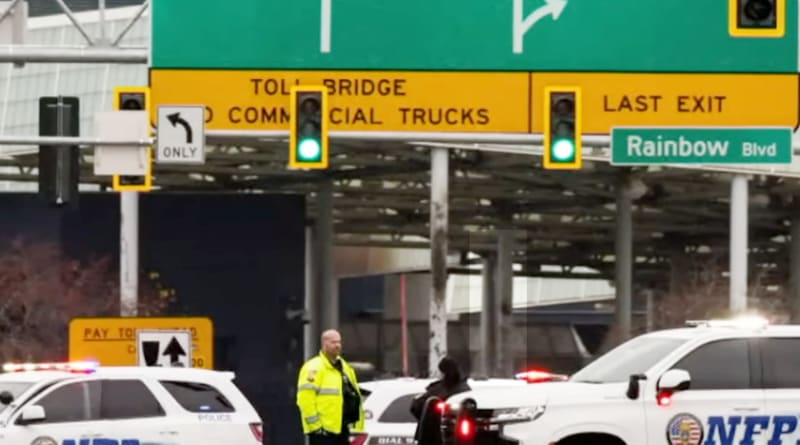

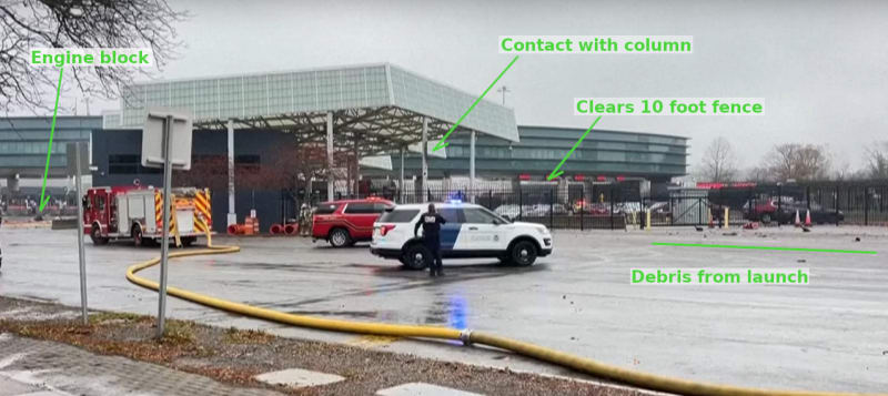

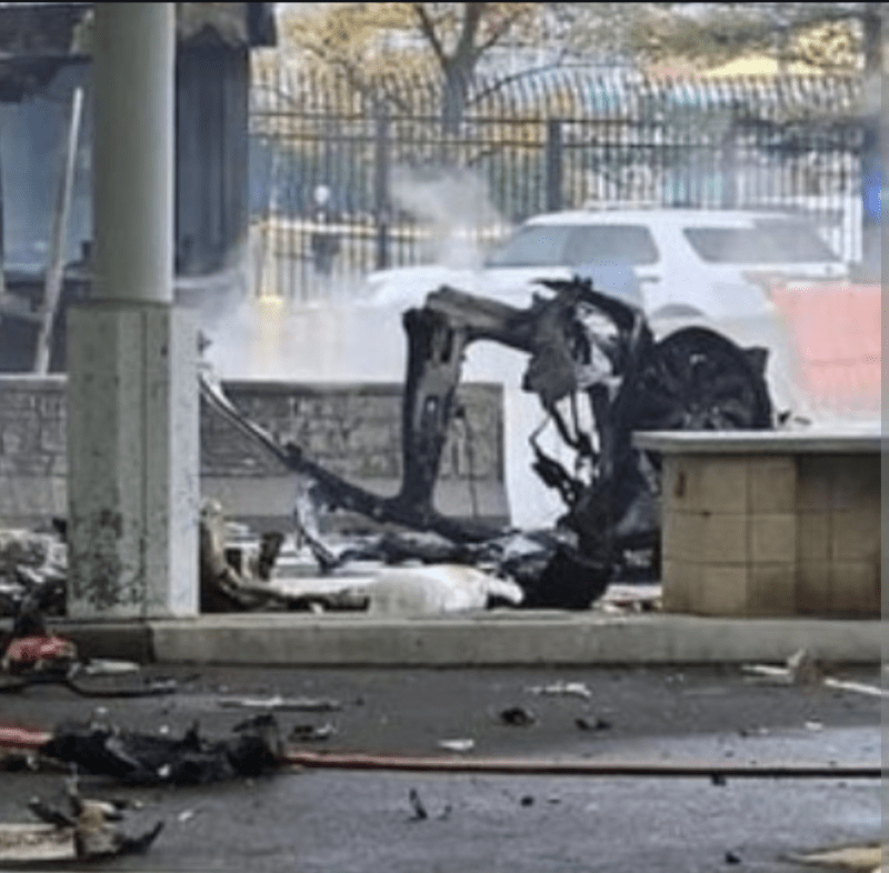

It blew the crash structure of the car apart. There was some serious power involved. See this picture or the side of the car, upside-down. That's the B-Pillar, some of the curved roof, and a bit of the frame of the car. The pressure did not originate outside of the cabin. CNG tanks are not placed inside of the cabin.
Why someone would want to blow up a crossing gate is an important question. I doubt this was the intended target. Maybe, the drugs kicked in a bit early.
It was not a bomb, there weren't explosives in the car. It was a gasoline fireball as the car broke apart. Going fast enough to get airborne for 3-4 seconds before crashing into a bunch of concrete while still airborne is rather good at tearing a car apart.

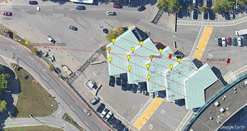

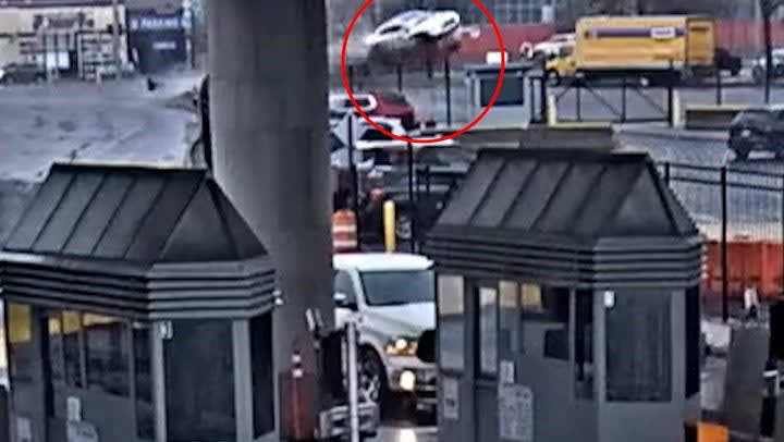

From the video, I estimate the vehicle covered 200 meters in 5 seconds, the last 75 meters being airborne. That's 144 km/hr or 90 mph.
In the following image, the green line indicates the line of sight in the video from the customs building security camera to just past the Twist o' the Mist shop where the vehicle first appears, and the red line represents the path of the Bentley to its destination in the secondary inspection area, which is an open air structure. Distances are estimated using Google Earth.
The vehicle likely launched off the grade differential up to the parking area.

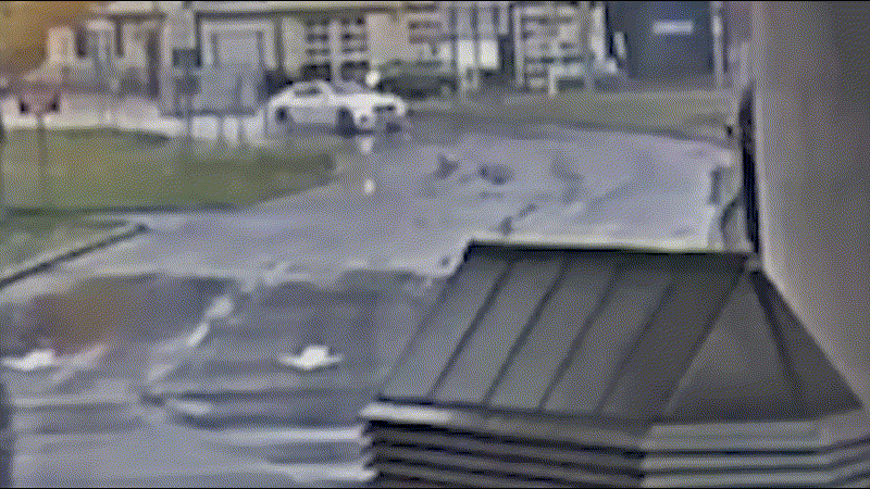

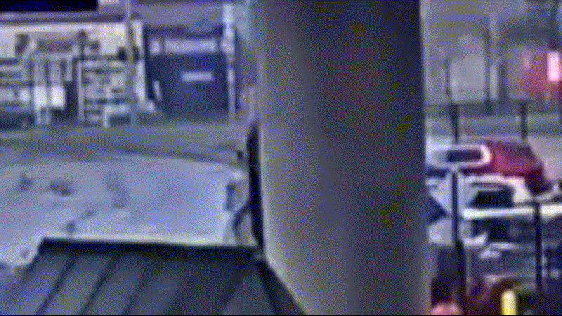

From a second clip at higher resolution but with the top clipped off.

Threading the needle, or more like threading the columns.

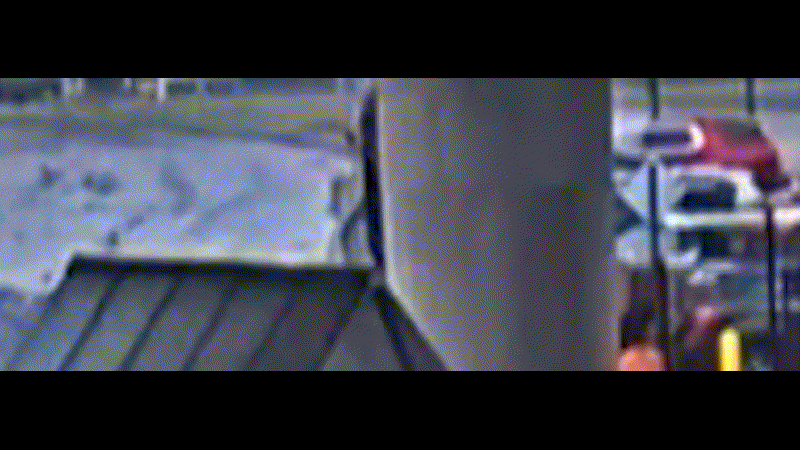

The first image shows two columns grazed as the vehicle threaded its way through the open air structure. The first column was contacted by the underside of the vehicle while the second is impacted by the top side. The Google Earth view indicates some of the column layout.
Unfortunately, concrete columns impede the view from the security camera when the vehicle grazes each of the two columns. The final two frames show debris trailing the vehicle.
WCNC on Youtube
I'd say one of the columns hidden behind the big cement pillar went through the windshield which ripped the roof and back half of the car from the rest of it. That'd be why the roof, part of the door pillars and the rear suspension is a separate piece apart from the other leftover piece of the body, which appears to have ended up against the cement base of one of those columns in another picture I saw.
