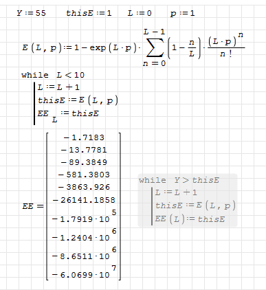

If Y is known, how can this be setup to solve for l?
Thank you.
Loopy l is more like an index than a measurement I think, and given that p=1 that equation is not very frightening at all.
I don't think Solver is the right approach, just loops.

I am playing with the FOR and WHILE loops right, and despite the examples online I'm a bit lost. Can you elaborate how to set this up?
This is from a paper that proposes a procedure for determining the capacity of a surge bin between two machines based on their rates, availability, etc.
In pseudo code, since I don't have mathcad
Y=user input
L=1
P=1
thisE=Y
while thisE<Y
L=L+1
thisE=longcomplicatedfunctionof P and L using a for loop
end while
print(L)
end
The problem I have with it is that unless I have mistranscribed your equation, E is always negative

So here's how I did it in Smath, a very similar program to Mathcad. You can see why I am confused- the grayed out section would give the L you want, but since all values of E were negative it is no good. You need to reset L to 0 or delete the active while loop to use the second one.

Have you tried graphing the equation? Keeping E as a function of L, with increasing L, the graph =<0.E(2)= -6.373, after which a step is seen, giving -14.273 and, with increasing L, the curve goes negative rapidly. Looks as though the solution is highly dependent on your given Y.
